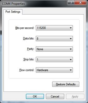

You can also try using Hyperterminal (or some other terminal), instead of Unico, to check the functionality of the virtual COM port driver.
Please find below the settings I am using in Hyperterminal:
Once you connect the COM port, you can send the command *ver and see if the board respond.

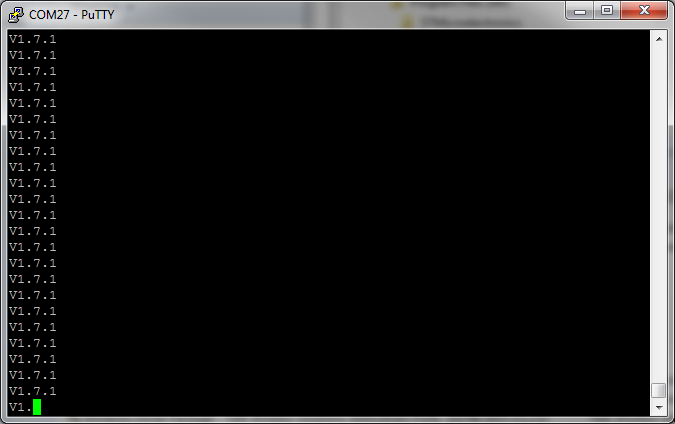

- Using a terminal program (putty.exe) to open the virtual COM port resulted in something more interesting when I did the following:
  1. After getting the
    generic 'Cross-platform UI for MEMS demo kits has stopped working' Windows dialog, I used my terminal program to open the virtual COM port (COM27). Note that I did NOT power off the evaluation board by unplugging the board from the USB port before performing this step.
  2. I get spammed with a continuous stream of V1.7.1 as shown in the following screen shot. My guess is this is why Unico is crashing. Perhaps our evaluation board has old firmware?
Note that if I do power cycle the evaluation board before step 1 (ie. using putty.exe to open the virtual COM port) then everything works as expected - the command *ver gets a single response of V1.7.1.
Do you think our evaluation board is running older, buggy firmware? If yes, can we upgrade the firmware using a terminal program? Thanks!

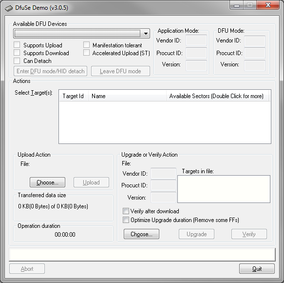

Anyway in the STSW-MKI109W package which you have downloaded is DFU directory, where you can find firmware compatible with the Unico 5.0.0.
There are also instruction how to update the FW in the board.

Hi Miroslav. We have the
STEVAL-MKI109V1 evaluation board. I've followed the instructions on updating the FW in the board, but I don't see our device in the 'Available DFU Devices' drop down menu shown below. From reading the DFU documentation it's not clear to me how to get our
STEVAL-MKI109V1 evaluation board into DFU mode. Do you know how this is done? We might just buy the latest evaluation board for LIS3DH since our evaluation board is obviously quite old.
