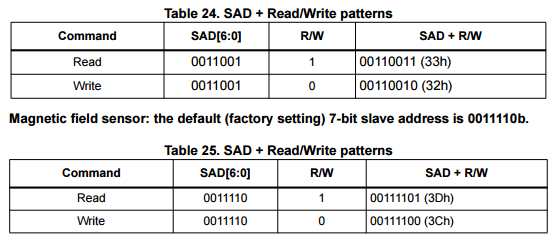

Hi, I'm new here and I am new at working on mems.
I have a LPCXpresso1549 evaluation board and a Steval-MKI172v1 mems that implements a lsm303agr chip.
I'm working on mbed platform and I need to read values from accelerometer but I tried a lot and cannot read anything.
I connect pins for SCL and SDA, 3V3 to the VDD pin, the GND, and two digital pins to the CS and CS_A (chip select on lsm303agr).
I don't know what address my lsm303 has and I can't understand what address I need to write on registers

If there is a VDDIO this needs to be the voltage source of the serial interface.
Read carefully the datasheet and if using the I2C, make sure you can read the WHO_AM_I_REG @0x0F properly for each function (Accelero and Magneto).
Check with an oscilloscope otherwise to make SURE the I2C is looking good and there is a pull-up on each line.
Or sweep all the I2C slave addresses until an ACK is detected...

If you are using I2C bus, you have to connect pull-up resistors on the SDA nad SCL lines. CS pins needs to be connected to VDDIO. VDDIO also connected to power supply.
The I2C addresses of the sensors are following.
