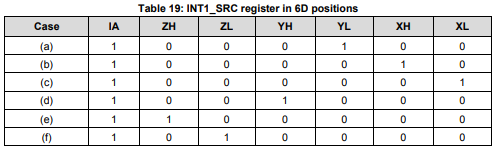

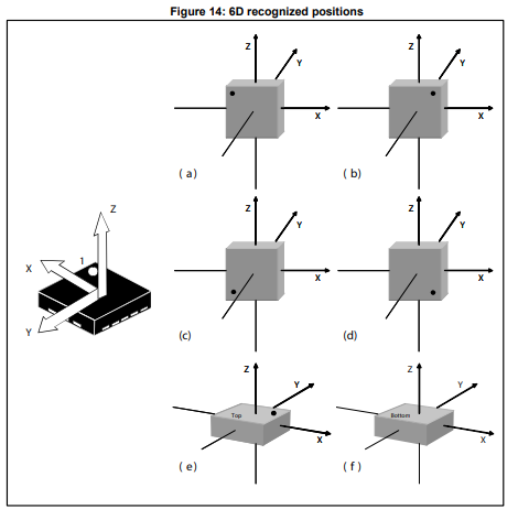

    You're welcome, @gb00​ . What I suggest you is to use the 4D/6D (INT1_CFG (30h) register for the setting, INT1_SRC (31h) for the polling). You will be able to detect the following positions:
    Do this embedded feature match you purpose?​ Regards

    ​Hi, Thanks for reply. Actually I want to detect acceleration w r t left, right and front (+Ve acceleration) and back( -ve Acceleration). Not position.
