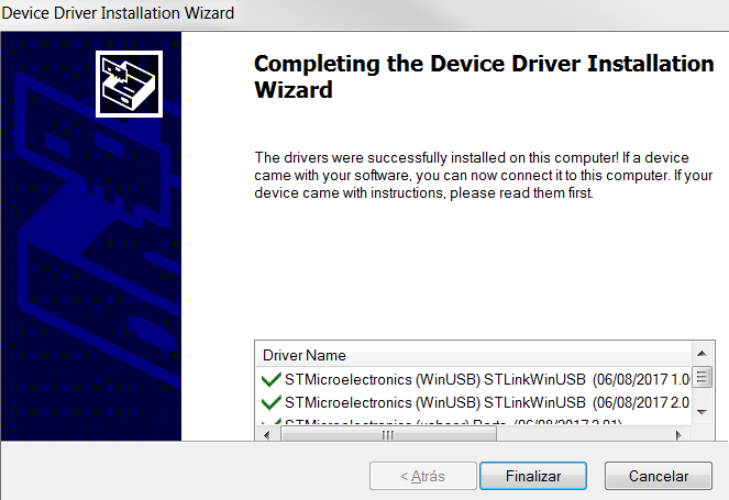

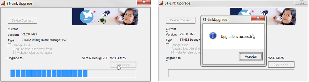

First, I install STSW-LINK007 and STSW-LINK009 as manual says.

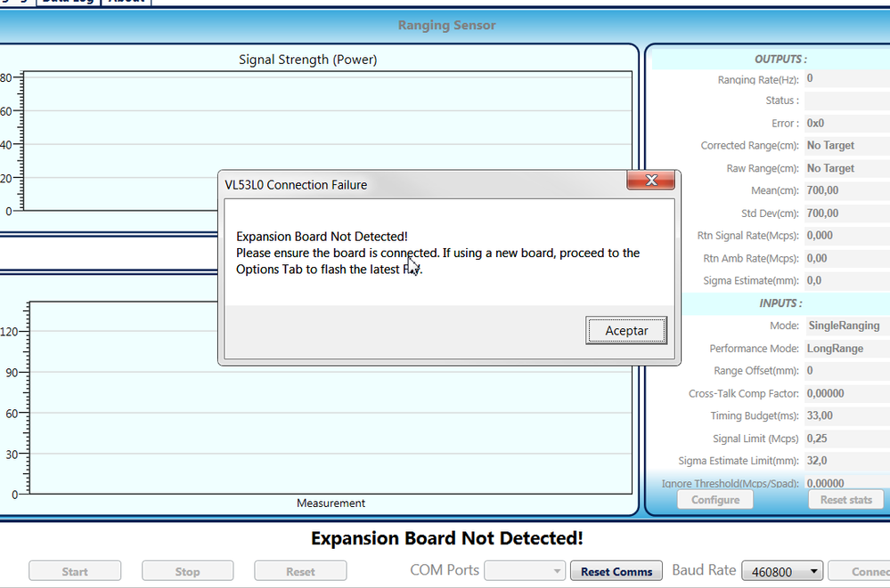

Then I connect X-NUCLEO-53L0A1 + NUCLEO-L476RG to my USB port, start the application and get the next error:
Why is this happening? Does VL53L0X GUI only works with NUCLEO-F401RE but not with NUCLEO-L476RG?

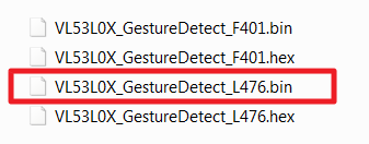

Note: I know my NUCLEO-L476RG and my X-NUCLEO-53L0A1 aren't damaged because I can download the VL53L0X examples and they work well:

John E KVAM
Unfortunately we have only written the GUI to support the STM32F401 Nucleo-64 board.
So nothing is broken and you did everything correctly, but you need a different MCU board.
Good news is that they are only about $10, and quite available from Mouser, Digikey or wherever you bought your original kit.
Sorry about that.

Hardwariano
Hello John
thanks for confirming what I suspected. I'll buy STM32F401 Nucleo-64 board then.
As a suggestion, please clearly specify in the manual that the only compatible PCB is F401 to avoid confusion. I though NUCLEO-L476RG was compatible with the GUI because there were some examples developed for VL53L0X and NUCLEO-L476RG.
