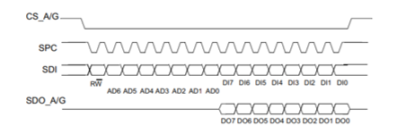

about the 4-wire SPI issue, are you failing the whole SPI communication or are you able -for example- to correctly read the WHO_AM_I (0x0F) register, but you are wrongly acquiring / decoding the data?
In the first case, you have to check if you are using the SPI Mode 3 (i.e. CPOL=1, CPHA=1), as stated in the datasheet, p. 31:
0693W000008GFYCQA4.pngYou should check this configuration from your master SPI side.
I suggest you to use a scope for signal integrity double-check.

Hi @Aaronium​ ,
well, the device is not "ready to go" just after startup in the sense that you have to set the configuration registers to set the device in a "receptive" mode (ODR setting, FS, Mode...). For a basic configuration you can refer to Github examples you might already know.
As additional question from my side, are you correctly configuring all the 4 wires of the SPI (especially the CS line)? Could you share the screen of a scope, for completeness?
-Eleon

Hi @Aaronium​ ,
sorry for the delay in my answer.
You say that you are able to write in the registers in SPI 4-wires but when you read back the registers it seems they are always 00h, right? the Are the Vdd/VddIO always connected? Are you correctly implementing the 8-bit SPI Mode 3 as described above? (I'm afraid an oscilloscope is mandatory...)
-Eleon
