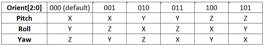

LSM9DS1 has the register ORIENT_CFG_G(13H).
What mean its bits     Orient[2:0]    Directional user orientation selection ?

    The bits Orient [2:0] in register ORIENT_CFG_G (0x13) can be used to change the axis orientation, as reported in following table.

    Thank you,
    this table I've found in the datasheet for LSM6DS3US (September 2017  DocID028476 Rev 5).
    As I use datasheet for LSM9DS1 (March 2015  DocID025715 Rev 3) the table is absent here.

    The datasheet DocID025715 Rev 3 from March 2015 is the latest one.
    Yes, the table is missing there, it should be fixed soon.
    There is no other document for LSM9DS1.
