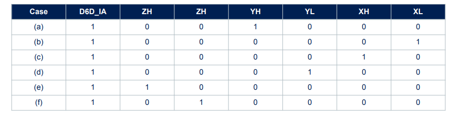

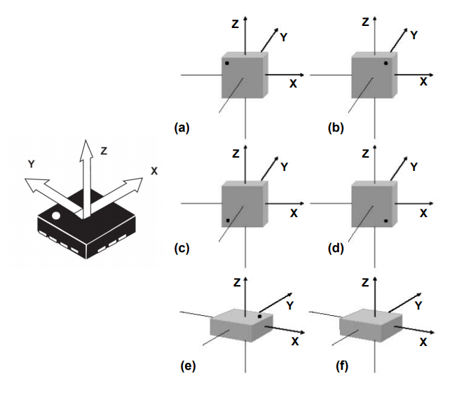

The device provides the capability to detect the orientation of the device in space, e.g. for automatic image rotation for mobile devices. Six orientations of the device in space can be detected; the interrupt signal is asserted when the device switches from one orientation to another. The interrupt is not re-asserted as long as the position is maintained. 6D interrupt is generated when, for two consecutive samples, only one axis exceeds a selected threshold and the acceleration values measured from the other two axes are lower than the threshold: the ZH, ZL, YH, YL, XH, XL bits of the INT_GEN_CFG_XL register indicate which axis has triggered the 6D event.
  • 6D is set high when the device switches from one orientation to another.
  • ZH (YH, XH) is set high when the face perpendicular to the Z (Y, X) axis is almost flat and the acceleration measured on the Z (Y, X) axis is positive and in the absolute value bigger than the threshold.
  • ZL (YL, XL) is set high when the face perpendicular to the Z (Y, X) axis is almost flat and the acceleration measured on the Z (Y, X) axis is negative and in the absolute value bigger than the threshold.
You can set all the mentioned thresholds in registers INT_GEN_THS_X_XL (07h), INT_GEN_THS_Y_XL (08h), INT_GEN_THS_Z_XL (09h), while the interrupt duration can be set from the INT_GEN_DUR_XL (0Ah) register.
Here a brief visual description of the feature:
