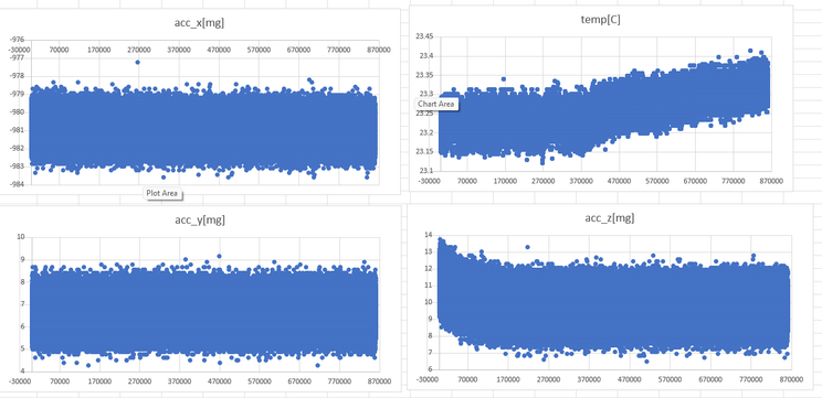

The measurements below, taken from a lab report ST kindly provided as a response to our application, are similar in nature to our own measurements.
One can (hopefully, given the tiny images) see that even though the temperature changes very little (not sure why it has less samples than the acceleration) some accelerometer axes show a very slow convergence. The amount of change in the accelerometer reading is far larger than what is expected according to the datasheet numbers for temperature sensitivity.

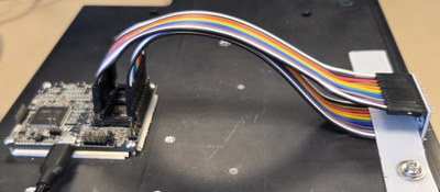

We, per the claim above, enlarged the decoupling of the component from the main board by longer wires:

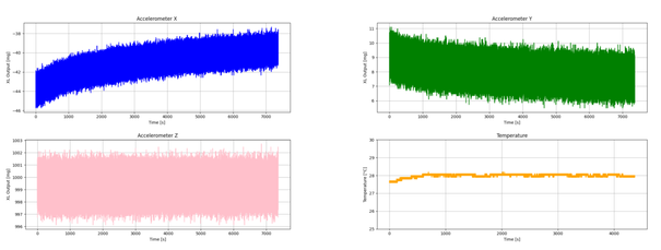

As one can see below, the behavior of the z axis is hard to correlate with the temperature. Note here the x axis of all graphs is given in samples (at 240Hz) and not seconds:
We can not explain why the lab setup of ST does not exhibit this behavior. Maybe the sensors are always on and already relaxed to the asymptote value when the recording was made. This is something we cannot do in real life.
