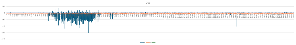

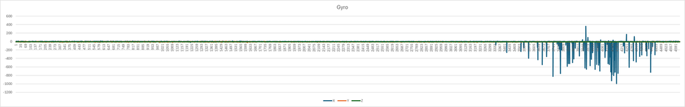

I'm working on a project where I use the LSM6DSRX. I have noticed that the Gyro has a strange behavior, reporting peaks on the X axis while the device is solid static. The peaks may be correlated to the temperature change but it's not clear yet. I did run a test, on ambient temperature range +5C to +30 with two end-devices (DUT1 & DUT2) and one of the two reported the peaks on X axis at around 33C (internal temperature) while the other not. Is this something you have ever experienced or reported by any user? Since now all of my experiments shows that it is device related and not system related. I have replaced the LSM on some of the faulty and the issue seams to have been resolved. I have taken X-ray scans to verify that the soldering is acceptable and it is.
Following raw data as read from the sensors Gyro from 3 different devices. You may see the noise coming after a few minutes with a duration of around 50-60 minutes The samples are taken every second. The noise is always on X axis.

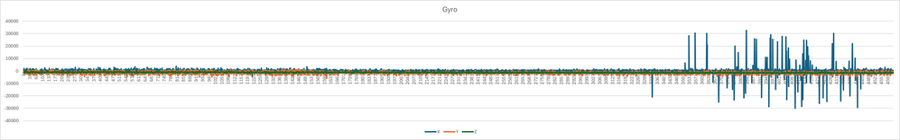

A longer duration test around 5 Hours.
