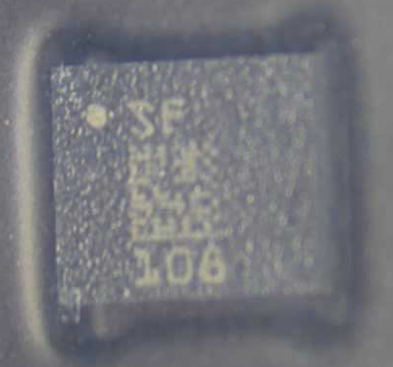

Hi!
Our incoming inspection unit failed to find any information on LSM6DSLTR device marking. We got parts with 2 lines on it.
SF
2D code
106
Could you please confirm it is a LSM6DSLTR device? Is there date code on it?
Peter BENSCH
Yes, SF designates the LSM6DSL.
The date code is given in the last line, 106 stands for 2021, week 6.
Does it answer your question?
Regards
/Peter

Hi! Peter!
Thanks a lot! Have a nice day!
