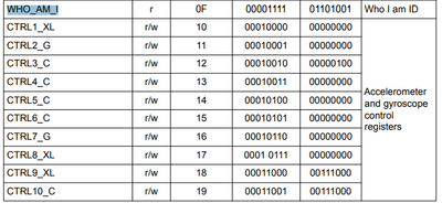

Hello! I'm having a problem getting data from the LSM6DS3 sensor. When I try to read the value of the "WHO_AM_I" register, I get too short pulses in response that cannot be read by applying it to its clock.
I am using this sensor board. SPI. The main one is STM32F411.

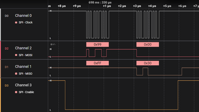

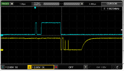

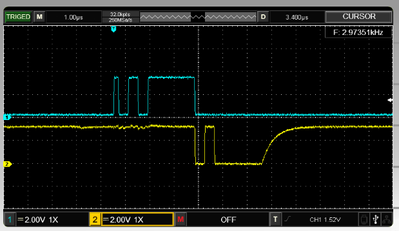

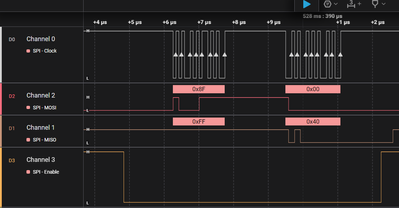

In the case when I send the value 0x8F, I get the result as shown below. At the same time I should get the value 0x69 or 01101001 in binary form. And if you look carefully at the results below, you will see that something is interfering, the pulse is too short to be recorded.
I tried to read the value in other "CTRL9_XL" registers and there is such a situation. I should get 00111000, but I got 00110000, as if the pulses were not compressed and written one less value:

SPI mode set in the STM32 matches the mode expected by the LSM6DS3. If necessary, try switching to CPOL=0, CPHA=0 (Mode 0) and see if that resolves the issue. If you fear that your sensor itself is faulty, you can cross-check the sensor with an Arduino UNO with the sample code and library given here: https://learn.sparkfun.com/tutorials/lsm6ds3-breakout-hookup-guide/all
