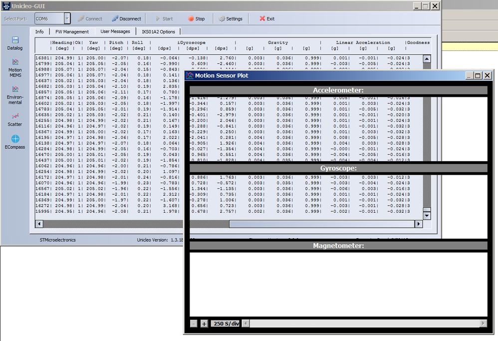

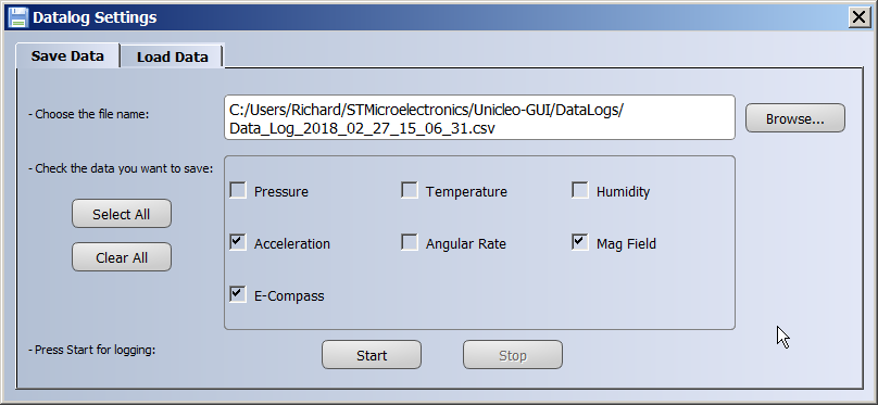

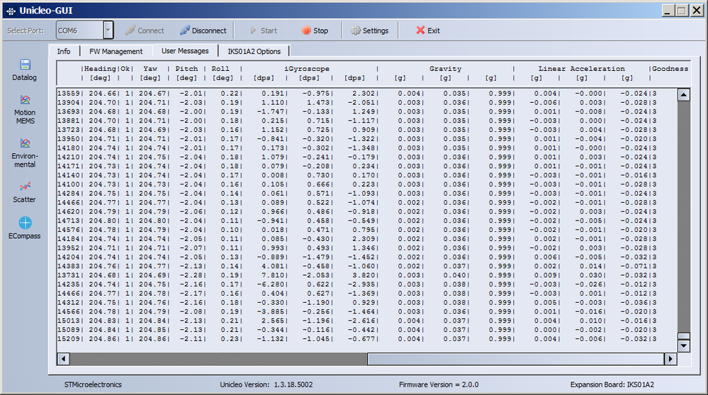

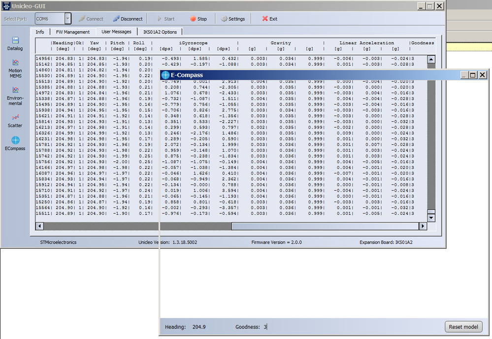

I have now purchased a NUCLEO-L476RG development board with X-NUCLEO-IKS01A2 expansion board to evaluate the e-Compass using the Unicleo GUI Windows app. I have built and downloaded the required firmware to the development board and the GUI is working to a point. I can view the realtime sensor data by clicking on the User Messages tab, and I can log the data to file using the Datalog button, but if I click on the ECompass button then the frame of the ECompass window displays, but the graphic of the compass does not. The same sort of thing happens if I click on the Motion MEMS, Environmental or Scatter buttons.

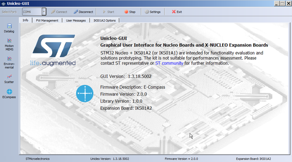

I am running version 1.3.18.5002 of the GUI on Windows 7 with V2.0.0 of the E-Compass firmware (V1.0.0 library) on the STM32 Nucleo board.

we have discovered this issue recently and we are working on a patch.
The problem is missing OpenGL drivers v2.0.0 or higher on your PC.
You can try to update drivers for you graphic card, if it will not help please send me your email by PM and I will try to send you OpenGL software library, which should solve the issue.
