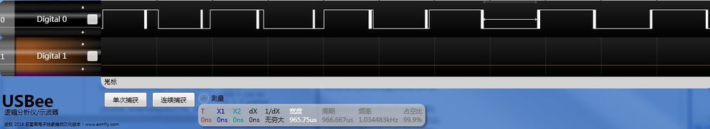

Hello ,everyone.
Now, I have some prolem about LIS3DSH .
I tried run ''state machine'' LIS3DSH presets WakeUp from AN3393 page 78, but anything I do, the interrupt occur on INT1 all the time. What is the Problem ?
These codes debug on my device:
LIS3DSH_GetWHO_AM_I(&tmp);
printf(''whoamI?.........\r\n'');
if(vtmp==0x3F)
printf(''IamLIS3DSH(0x%d)\r\n'',tmp);
else
printf(''Iam???~\r\n'');
LIS3DSH_WriteReg(0x21,0x01);
LIS3DSH_WriteReg(0x23,0x48);
LIS3DSH_WriteReg(0x20,0x67);
LIS3DSH_WriteReg(0x57,0x55);
LIS3DSH_WriteReg(0x59,0xFC);
LIS3DSH_WriteReg(0x5A,0xFC);
LIS3DSH_WriteReg(0x40,0x05);
LIS3DSH_WriteReg(0x41,0x11);
LIS3DSH_WriteReg(0x42,0x00);
LIS3DSH_WriteReg(0x43,0x00);
LIS3DSH_WriteReg
(0x44,0x00);
LIS3DSH_WriteReg
(0x45,0x00);
LIS3DSH_WriteReg
(0x46,0x00);
LIS3DSH_WriteReg
(0x47,0x00);
LIS3DSH_WriteReg
(0x48,0x00);
LIS3DSH_WriteReg
(0x49,0x00);
LIS3DSH_WriteReg
(0x4a,0x00);
LIS3DSH_WriteReg
(0x4b,0x00);
LIS3DSH_WriteReg
(0x4c,0x00);
LIS3DSH_WriteReg
(0x4d,0x00);
LIS3DSH_WriteReg
(0x4e,0x00);
LIS3DSH_WriteReg
(0x4f,0x00);
LIS3DSH_WriteReg
(0x5B,0x01);

Posted on March 08, 2016 at 11:05
the INT1 logic output:
