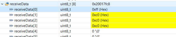

for example:
With initialization as above and then later reading a non zero accel register:
 transmitData[0] = (uint8_t) (LIS3DSH_READ | LIS3DSH_Z_H);
 SPISend( transmitData, receiveData, 4);
Results in:
So the value in LIS3DSH_Z_H is repeated 3 times as (0xc0) rather than stepping forward from address OUT_Z_H (0x2D) to reading FIFO_CTRL(0x2E), FIFO_SRC(0x2F) etc.
It seems that maybe an additional bit needs to be set somewhere?
