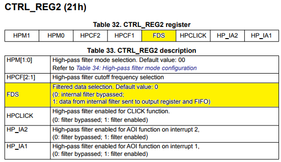

Hi All.
I want to configure the filter in such a way that the data in the out registers are not filtered, and the data for interrupt AOI are filtered. But I have filtered data in both the interrupt and the output registers.
My settings of filter: AX_Write (0x21, 0xC1);
Whats wrong?

‎2018-11-09 4:11 AM
If the FDS bit is 0 the in output registers are without high-pass filter.
Can you read back the CTRL_REG2 value and confirm the configuration?
‎2018-11-12 5:05 AM
"If the FDS bit is 0 the in output registers are without high-pass filter." - that's the question!
I read back all the registers that have been configured. The read data is the same as what was recorded.

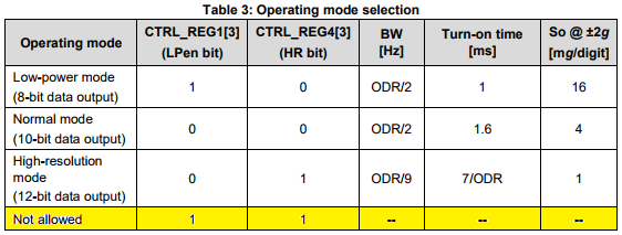

‎2018-11-13 2:43 AM
OK, I see.
First of all, you use not allowed configuration:
Please set the HR bit in CTRL_REG4 to 0, it should start to work as expected.
I will check if the "Autoreset on interrupt event" mode can work also in Normal and High-resolution mode.
‎2018-11-13 2:56 AM
Miroslav, thanks for your time. The device worked as it should after setting the HR bit to 0.
‎2018-11-19 7:03 AM
One more thing:
"Autoreset on interrupt event" high-pass filter mode can work in High-resolution sensor mode only if FDS bit is set to 1. In case accelerometer raw data (not high-pass filtered) are needed on output data registers, Normal or Low Power mode has to be used.
