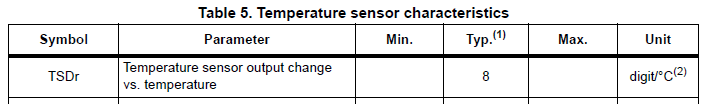

‎2018-06-06 10:57 PM
Hi Winfred,
I am able to read the values of TEMP_L, TEMP_H. How can i convert these values to
Celsius ?
Regards,
SHAMMI
‎2018-06-11 4:09 AM
Hi SHAMMI,
Please refer to Table 5 in
http://www.st.com/resource/en/datasheet/lis2hh12.pdf
8 digit = 1 degree Celsius
So,
temperature in Celsius = ((TEMP_H << 8) + (TEMP_L)) / 8 + 25
Best Regards,
Winfred
