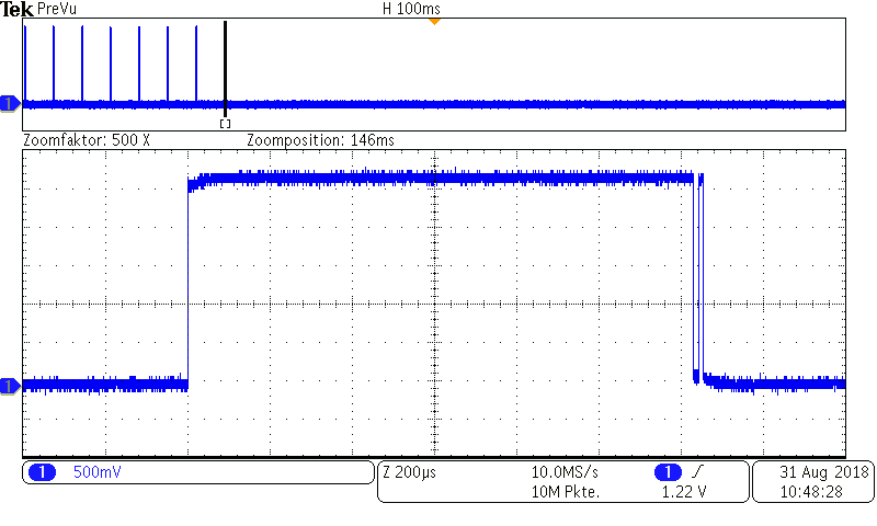

I'm using the LIS2DW12 accelerometer with 800Hz ODR in continuous mode. I've set the fifo watermark threshold to 25 samples and enabled the watermark interrupt on INT1-pin. I read the data from the fifo inside an interrupt-routine on a STM32 microcontroller.
The application works and the data can be read correctly. So far so good...
Sometimes there is a second (unexpected) interrupt event generated by the sensor, right after the "normal" interrupt was set low again.
Here a screenshot from the oscilloscope on the INT1-Pin of the accelerometer:
This second pulse causes the microcontroller to enter the interrupt-routine again, although there shouldn't be new data available after this short time.

Can you please share your sensor configuration?
I guess it can happen when you read a one sample and then the sensor will put one sample to the FIFO and reach again FIFO watermark.

Miroslav BATEK
The configuration seems OK to me.
