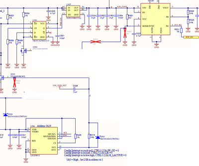

I am using lis2dw12 accelerometer connected to esp32s3 and recently have got a situation which is blocking for esp32s3 to read status registers of accelerometer when LIR =1 (latched mode). I put accelerometer on stationary  mode and routing the intruppt to INT1 which resets my esp32. Interrupt is working fine but when I want to read tap_source or wakeup_source or in general ALL_INT_SRC ( not pulling them. only one time) to detect the reset reason on my esp32 side, It will be hanged sometimes until esp32 watchdog happens and from that point the status register are readable since i2c is reinitiated I guess. Whould you mind please help me to underestand why acccelerometer get frozen?
Here is my configurations:
write2i2c(acc_addr, LIS2DW12_CTRL1, 0x10, 1)
write2i2c(acc_addr, LIS2DW12_WAKE_UP_DUR, 0x30, 1)
write2i2c(acc_addr, LIS2DW12_WAKE_UP_THS, 0x42, 1)
write2i2c(acc_addr, LIS2DW12_CTRL4_INT1_PAD_CTRL, 0x20, 1)
write2i2c(acc_addr, LIS2DW12_CTRL_REG7, 0x20, 1)
write2i2c(acc_addr, LIS2DW12_CTRL3, 0x10, 1)
and after reboot which takes only 10ms I try to read:
readfromi2c(LIS2DW12_I2C_ADDRESS, 0x27)
readfromi2c(LIS2DW12_I2C_ADDRESS, 0x39)
readfromi2c(LIS2DW12_I2C_ADDRESS, 0x3b)
then If it does not crash I will put accelerometer again in stationary mode again. but sometimes it get stucked in reading process above. it is worth mentioning that it only happend when Iam in latched mode.

Hi Federica,
Sorry for my late response due to the holidays. I actually found the problem but I have no proper explanation for the reason of that. As I mentioned above I only try to put the accelerometer in the stationary after each esp32s3 power on. Accelerometer can wake up the esp32s3 since the INT pin is connected to esp_pwr_on pin( you can see in the schematic). The faulty scenario happens when I set accelerometer in stationary + latched mode enabled(LIR = 1).
Faulty scenario: while I bring the accelerometer out of latched mode (LIR=0) and wait for wakeup source register clean up through polling loop, If I shake the sensor during reconfiguration, it will finally come out of the polling loop and Accelerometer goes to latched mode again( here something happens) and I will not be able to read or write from/to accelerometer until shaking stops for next configuration.
*****after every power on of esp32 I have the following code immediately:
 // wait until WU_IA and TAP_IA flag is reseted otherwise it will stay set
do
        wakeup_source_reg = readfromi2c(acc_addr, 39h)
 } while ((wakeup_source_reg & 0x0f));
========================================> I have noticed that when execution reaches here, there should not be any movement for accelerometer( wakeup_source_reg = 00) and not any interrupt should not happen before configuration. I am sure about that since I have tried a lot to keep the accelerometer stationery before this line execution and it will never crashes================= >
write2i2c(acc_addr, LIS2DW12_CTRL10x101)
write2i2c(acc_addr, LIS2DW12_WAKE_UP_DUR0x301)
write2i2c(acc_addr, LIS2DW12_WAKE_UP_THS0x421)
write2i2c(acc_addr, LIS2DW12_CTRL4_INT1_PAD_CTRL0x201)
write2i2c(acc_addr, LIS2DW12_CTRL_REG70x201)
========================================> if  accelerometer is not steady( still shaking) when execution is here then it will latched one or two consecutive  WU_IA and for the next power on when we want to read the wakeup source register the watchdog trigger in the esp side happens  ================= >
 +++++I is worth mentioning if accelerometer is steady within the above execution until esp32 goes to power down, any movement powers on the esp and if accelerometer gets steady before the above code execution it will never crashes
farshad_0-1704295437095.png esp_en goes to esp32s3 pwr_en pin
