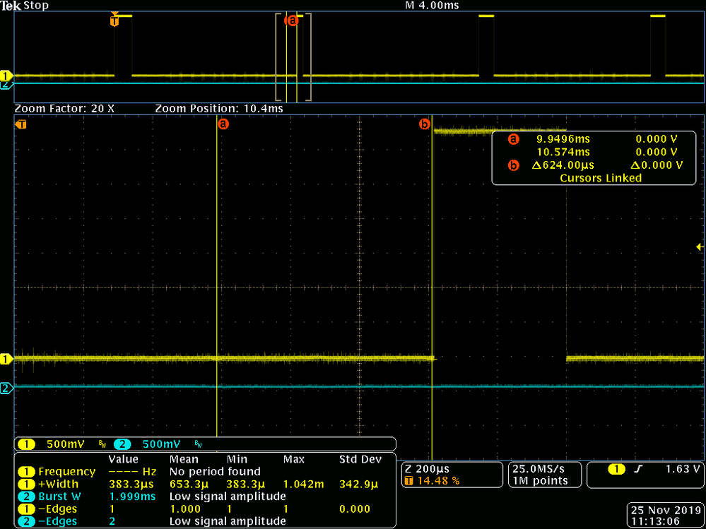

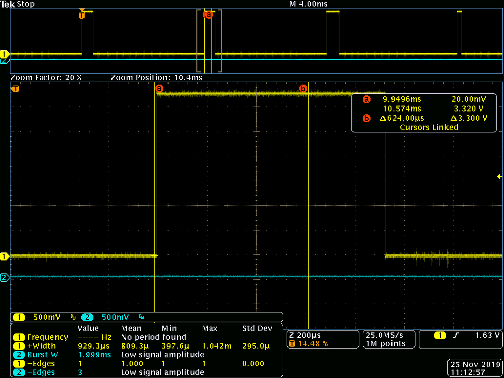

When I'm using the LIS2DW12 at ODR=1.6kHz, the Interrupt for reaching the FIFO-Threshold is jittering with 1/ODR, but only if the threshold is greater than 12. If it's less or equal, everything is working fine.
The buffer-Mode is set to FIFO-Mode, but this behaviour also occurs in Continous-Mode.
The Power-Mode is set to High-Performance/Low-Noise.
The Interrupt is routed to the INT1-Pin
The two images show the rising edge on the pin INT1. The time between the two cursors "a" and "b" is 624us (almost 625us), which would equal to 1/ODR (1/1600 = 625E-6)
As written, this only happens if ODR is set to 1.6kHz and the FIFO-Threshold is greater than 12.

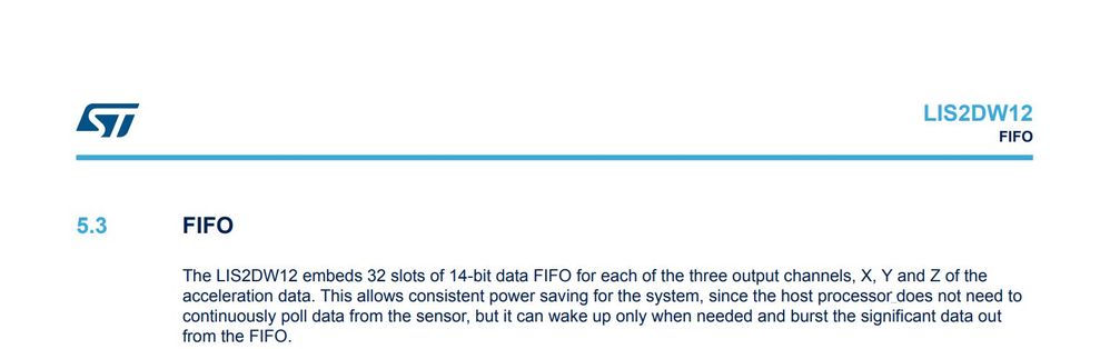

From the informations provided by the datasheet I thought, the FIFO would contain only the acceleration data.
Additionly I assumed, that a FIFO-threshold of 12 meant that there is an Interrupt when I have 12 Samples (each consisting of 3 Axis * 2 Bytes/Axis) in the FIFO, which would result in a total of 72 bytes of data.

I'm sorry, the gyro part doesn't make sense :) I was confused from a parallel thread on iNemo FIFO.
Basically you well interpreted the documents, the threshold refers to the complete filling of the 6x12 bytes.

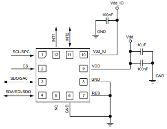

I also included the relevant part of the schematics.

Hi Loris, it would be of great help if you could send us your PCB, if it is not of too much effort for you. Can you however share your application .bin file? I don't use MDK-IAR... Regarding your schematic, and the decoupling capacitors in particular, they are not as the suggested ones... This should not be an issue, but let's take it into account

Regarding the Capacitors:
I've seen this as well while checking and we will probably change with the next redesign, but I also assumed, that this isn't the problem.
