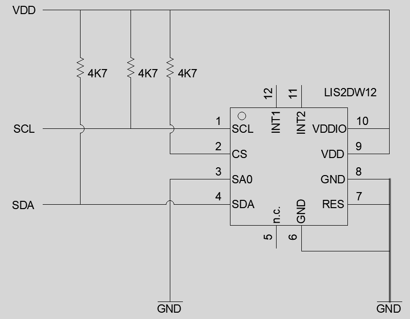

I use Arduino to read the LIS2DW12 sensor. The circuit of sensor was as below.
According to the circuit, the I2C address was 0x18. But when I use Arduino to scan the address, sometimes it has no response. Has any connection I miss?

Hi @Kchue.2​ ,
the address (on 7 bits) looks correct, according to the SA0 value (datasheet, p. 28):
0693W00000AMcCJQA1.pngBut did you try all the #256 I2C possible addresses?
What I would suggest you is to try to set the SA0 pin to Vdd, if possible, and re-dun the I2C scan. Also, you could try another LIS2DW12 if you have the possibility, just to exclude an issue specific of that device.
Another suggestion is to open an issue report directly on Github for more help in case the issue is effectively related to the software routine.

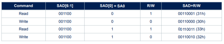

On datasheet 6.1.1, the Slave Address (SAD) associated to the LIS2DW12 is 001100xb. And "x" was depend on SA0/SDO connect with Vdd or GND.
But it also mention "The slave address is completed with a Read/Write bit". Is it mean I2C address should be 0x30~33, instead of 0x18~19?

Hi Kevin,
>> About SA0 connection, what is functional difference for connected Vdd and GND?
There is no functional difference, but in this way (i.e. choosing the SA0 polarity) you'll be able to place two sensors on the same I2C lines, since you'll have two different I2C addresses.
Yes, the 0x30~33 is the slave address on 8-bit, i.e. with the additional R/W bit, while 0x18~19 is on 7 bit. In the resulting I2C pattern (on 8-bit) the 0x30~33 is the one to be considered, as shown in the picture I previously posted in my comment.
-Eleon
