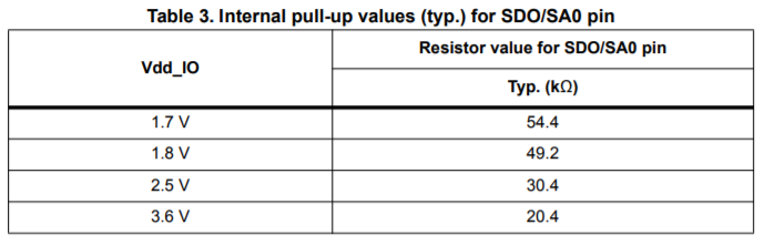

Eleon BORLINI
Hi @党军 �?�​ ,
Let me please better understand the point.
Are you using the I2C protocol for the communication right?
How did you set the SDO/SA0 pin at hardware / firmware level?
Please note that this is pin has Internal pull-up, and if you are connecting it to the GND layer you have to take into account of the consumption coming from the pullup resisters (see datasheet, p.9):
0693W00000DnNXDQA3.pngOr otherwise, you should tie the SDA/SA0 pin to Vdd or disconnect it.
If this is your issue and my reply answered your question, please click on Select as Best at the bottom of this post. This will help other users with the same issue to find the answer faster.
-Eleon
