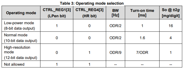

I have several boards with lis2dh12 and all of them keeps return constant data for lis2dw12_acceleration_raw_get function, every board has its own constant, 0x5050, 0xe0e0, 0x7070.
I tried using the STEVAL-MKI135V1 connected to STM3220G-EVAL to test maybe our implementation and board design is the problem, but the same happens, it returns constant 0x6060.
We also have some boards that we use lis2dw12 instead, everything else is exactly the same, and it works great with the drivers for this sensor.

‎2021-11-15 11:55 PM
there is an answer from the ST support.
They explained that in order to have multiple-byte read with I2C on lis2dh sensors, there is a bit in the subaddress field that should be set by the user.
As mentioned in datasheet: "In order to read multiple bytes, it is necessary to assert the most significant bit of the subaddress field. In other words, SUB(7) must be equal to 1 while SUB(6-0) represents the address of first register to be read."

Hi @Ywo.1​ ,
yes, actually the two devices differs only for the footprint, and not in the relevant registers.
Are you waiting the turn on time before starting the acquisition?
And are you using the I2C or the SPI lines for communication? I'm wondering whether this could be an issue related to the multiple bytes reading...
