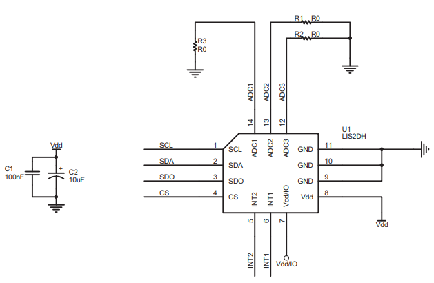

Please note that once the LIS2DH device is powered up, it automatically downloads the calibration coefficients from the embedded flash to the internal registers. When the boot procedure is completed, i.e. after approximately 5 milliseconds, the device automatically enters power-down mode. So if there is some over-current consumption after this procedure and before the first SPI of I2C communication with the sensor, there could be some issue in the hardware connection / schematic. Can you please share it or check if it is coherent for example with the STEVAL-MKI135V1 one? Vdd and VddIO can be tied together.

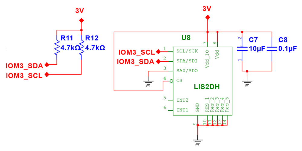

This is my schematic and I made connections just as in reference design.
We got boards made from 2 manufacturers and all boards test like this. Please advise.

Hi @PK.1​ ,
the hw connections looks ok... can you try to separate Vdd and VddIO and try to power them separately?

Hi @PK.1​ ,
I checked and the SDA and SCL lines on the LIS2DH ASIC should be internally connected to positive supply voltage via (weak) pull-up resistors. So, if you force them to GND through application processor, you could experience an over-current consumption (150uA is somehow high and the pull-up path consumption should in case be dominated by your 4.7kOhm resistors, but can try to leave these pin floating at AP side).

Hi @Eleon BORLINI​
Can you also check how is the SA0 line internally in the LIS2DH?
In my schematic, it is connected to ground externally, so want to know if that can be the cause of high 150 uA power consumption.
Please let me know.
Hi @PK.1​ ,
SDO / SA0 pad (PIN#3) in effectively an Input/output pad with disconnectable active pull-up. The default pull-up value is about 50kOhm for a Vdd = 1.8V and decreases with the Vdd increasing. I can say you that to disconnect pull-up you should write ‘1’ in bit MSB of the reserved 1Eh register, but since this information is not in the datasheet, you should pay attention to these actions. You can try and see if the Idd decreases, but please take care of masking the other 1Eh-register bits.
