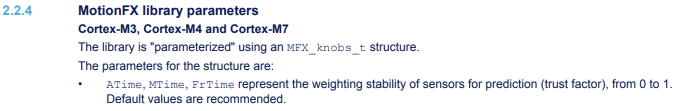

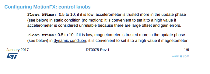

hi @Eleon BORLINI​ yes one of my problem was I calibrated it once at the beginning and never check again MFX_MAGCALGOOD. Also I needed to test with different values for Mtime,Atime,Frtime to get the linear acc and quaternions bout correct, for now it seems the data is ok.
Also I want to point, If someone is having problems? There are 2 different documents the older one DT0075 and newer one UM2220
FRTime,ATime and Mtime differ in this two documents. In the old from 0.5 - 10 and new from 0 - 1.
Old DT0075
0693W0000059wPCQAY.pngNew UM2220
Thanks, need some more tests to be for sure!
HI @suads​ ,
Thank you for your reporting.
Please refer to the second manual, the more recent user manual UM2220.
I'll check internally why we have two different indications online... The first one might refer to an older version of the Sensor fusion library...
