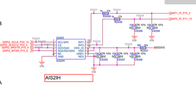

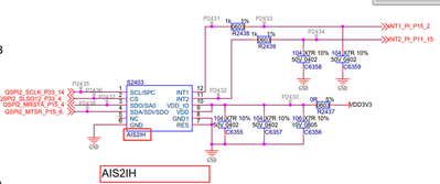

We have used the official code, but the measured values still do not match the actual situation. The most intuitive example is that when we apply acceleration on the X-axis, the X-value reads 0 while other axes show values. Could it be that our hardware connection method is incorrect? Could you please help evaluate it? Here is our schematic diagram.
Thank you very much!
Thank you for you reply!
When we apply acceleration to the X-axis, the displayed acceleration value of the X-axis is 0, which is obviously incorrect. We have referred to the data sheet and official code, but still failed to find a solution. Here is our hardware schematic diagram. Could you please help evaluate whether it is reasonable? Thank you very much!
Note that everyone can see all replies - there's no need to repeat stuff to each contributor.
You can mention multiple people in one post using '@'
Do you see the same when you move in the other axes?
At rest, do you see ±1g in each axis, according to orientation?

Maybe there's something wrong in how you display it, and/or how you process it?
Have you looked at the raw values received direct from the sensor?

The previous examples were all given by me to help you understand quickly. The actual situation is that the X, Y, and Z axes all have acceleration values, and they are all changing. In a stationary state, the Z-axis has an acceleration of 1g, and the X and Y axes have an acceleration of about 0.3g. When the chip is shaken, the acceleration values do not change much.

In the original post you said, "one axis continuously outputs a value of 0" - so is that now fixed?
So what happens if you change the orientation of the device?
Can you get the X axis to show 1g, in the appropriate orientation?
Can you get the Y axis to show 1g, in the appropriate orientation?
