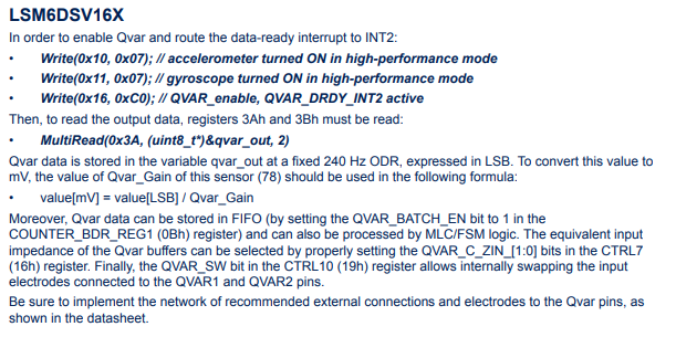

Hi, I would like to know if there are a library and a function to acquire QVAR data from the ST sensor LSM6DSV16X as for example it is present for the ILPS22QS sensor for Arduino using a Nucleo-64 stm32 board.

There isn't a library only for Qvar sensor but you can refer to the Application Note AN5755.
In section 4.2, there is the register configuration for LSM6DSV16X to enable the Qvar sensor and how to read the results.
_legacyfs_online_stmicro_images_0693W00000bjSX6QAM.pngIf my reply answered your question, please click on Select as Best at the bottom of this post. This will help other users with the same issue to find the answer faster :)
