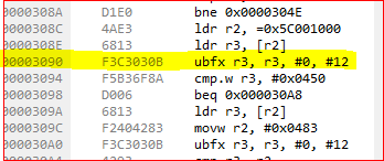

  1. I am trying to implement pedometer functionality using stm32F446RE nucleo board. I am using same API's but I getting Hard Fault error in this "void MotionPM_Initialize(void)" function.
  2. When we invoke those API's & I build, the build is successful but when we run project in this library rising exception(Hard fault error). we though that this are simple library directly we can use it is there any particular way to implement.

Hi @SKuma.23​ ,
if you are using the NUCLEO-F446RE board, I suggest you not to start from scratch at the beginning, but to refer to the FP-SNS-ALLMEMS1 firmware function pack, which implements the LIS2DW12 sensor drivers and some of the X-CUBE-MEMS1 libraries (unfortunately, not the Pedometer one, but you can add it taking inspiration from the already-implemented ones). You can find an example in the \Projects\STM32F446RE-Nucleo\Applications\ALLMEMS1 folder.
For the "Hard fault error", it could have been caused by a wrong configuration of the Pedometer library, and for this reason I suggest to check the settings of the implementation of the previous example.
