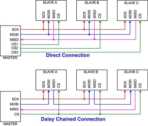

There are I2C bus multiplexers, but due to the high number of sensors, possibly the only alternative is to operate with SPI (daisy chained connection).
https://www.digikey.be/nl/articles/why-how-to-use-serial-peripheral-interface-simplify-connections-between-multiple-devices
I found this document that might be interesting to see:
Daisy Chain Implementation for Serial Peripheral Interface
Another option could be to use SPI in direct mode with 74HC595 to control the SS pin, need to observe the characteristics of Fan-in/Fan-out:
