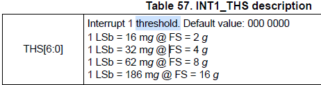

Question 1: Interrupts - First a dumb question. Do I need both INT1 and INT2? I have only configured INT1.
Question 2: Threshold Values - Second is my real question. Simply put I am having trouble understanding what the datasheet is saying in table 57 and what value I should be using in snt_iis2dh_threshold_set() to achieve my requirements stated above.
0693W00000NsiacQAB.pngHere is the math I am using:
- Requirements state that 5kph or 3.1mph is the magnitude to determine movement
	  -- 5kph = 3.1 mph = 1.38582 m/s
	  --  v = f(t) = 1.38582t^2, a = f'(t) = 2.77164t, f'(1) = 2.77164 m/s^2
	  - then to convert m/s^2  to mG:
	  	((2.77164 m/s^2  / 9.80665) * 1000.00) = 282.629 mG ~ 283 mG
 - iis2dh_int1_gen_threshold_set() then converts this to a range in mG to a range in uin8_t:
	  -- (283 + 15) / 16 = 18.625 mG ~ 19 mG
Looking through this site I find THIS discussion and in that discussion I see the following in the accepted answer:
/* Set interrupt threshold to 0x10 -> 250 mg */
  iis2dh_int1_gen_threshold_set(&dev_ctx, 0x10);
and in the original posters question:
INT2_THS = 0b00011000; //24LSB = 1.488 g
INT1_THS = 0b00001100; //12LSB = 192 mg
Also on this site I have found THIS discussion where I see the following:
"Thank you. That means if I set the threshold to 0x08 for +-2g full scale than 16*8=128mg value is set for threshold value. Am I right or wrong? "
So in the first example:
If the value passed to this function is then used in the following conversion:
0x10 = 16 (base10)
(16+15)/16 = 1.9 ~ 2 -> 0x02 written to the register so how does this equal 250mg?
Here is my understanding of mg/LSB:
Resolution = 8 bit so 256 possible measurements
+/- 2g is actually 4g's so each LSB is 4/256 = 0.015625 G = 15.625 mG which is roughly equal to 16mG which is what the datasheet says.
So in the register how does 00 0010 become 250mG?
16 * 2^2 = 32
In the other example where "16*8=128mg" if the 0x08 were written to the register and 1000 = 8 then 16*8 does in fact equal 128mG.
What I have come up with to pass to the threshold_set function is the following:
I need ~283mG but due to 16mG/LSB not possible but 288mG is so
to write 0x12 to the register I need to pass 273 to the threshold_set function. Is this correct?
Question 3: Activation - Thirdly, just be clear after INT1 triggers and accel values are read the interrupt flag is cleared, I don't really want repeated interrupts over and over again, so I think I set ACT_THS and ACT_DUR to put the sensor to sleep for a bit and avoid this. Is my understanding correct?
