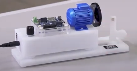

i bought sreval-stwinkt1 eval board plug and play eval board,
siva.1
I need an information that where it is placed on the motor?
Eleon BORLINI
Hi @siva.1​ , the placement of the STWINKT board could depend on what do you want to detect of the motor. For example, if you want to detect the vibration of the motor, you should screw it on the vibration motor case itself (same reference system) as shown in the picture below:
If you otherwise want to perform predictive maintenance with the ultrasound microphone, you are not strictly limited to screw the board on the motor, but you can just place it nearby the vibrating object.
In any case, I suggest you to check the existing online documentation (e.g. https://www.youtube.com/watch?v=J3M0_9EdOqU and https://www.youtube.com/watch?v=eRDRLiI2DyU)
Regards

Eleon BORLINI
Hi @siva.1​ ,
was this suggestion of any help for you? Or did you find a good way to mount the STWINKT1 on the motor?
Please note that the vibration sensor is in the middle of the board...
-Eleon
