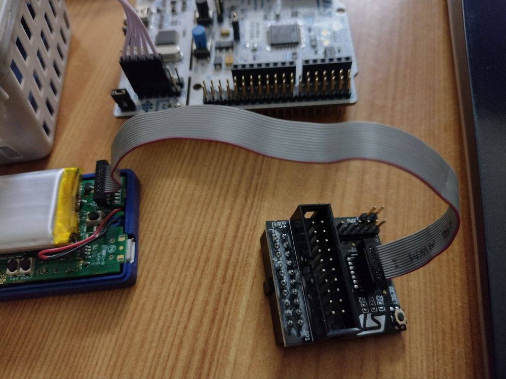

I am using Sensortile/box STEVAL-MKSBOX1V1. I have connected the device using NUcleo F401RE board for realtime debugging. How I shall enable Virtual Com Port
Snara.21
Senior
0693W00000Czq9PQAR.jpgI Have configured as shown in the picture , How should I enable the Virtual Com port,. My intention is evaluating all the sensors and push the data to Virtual COM Port.
  1. I am writing program for I2C_TempSensor - STTS22H  , for that I have configure from the port based on the circuit
USART1 – Pin No PA9 – Rx and PA10 Tx
is used for ST-LINK So we shall use this for virtual COM Port

controller STM32L4R9ZIJ6
So before proceeding I tried to display Hello using teeraterm , but no output seen

Hi, if you want to stream the data via USB / VCOM with the STEVAL-MKSBOX1V1, you can use the DataLogExtend example of the fp-sns-stbox1 pack, which sends sensors data via USB and using Unicleo.
https://www.st.com/resource/en/user_manual/dm00647052-getting-started-with-the-stm32cube-function-pack-for-the-pro-mode-of-the-sensortilebox-wireless-multi-sensor-development-kit-stmicroelectronics.pdf
https://www.st.com/en/embedded-software/fp-sns-stbox1.html
https://www.st.com/en/development-tools/unicleo-gui.html
You can upload the application .bin file in DFU mode without the programming cable.
Or you can configure the USB streaming with ST BLE Sensor app in Expert mode.
