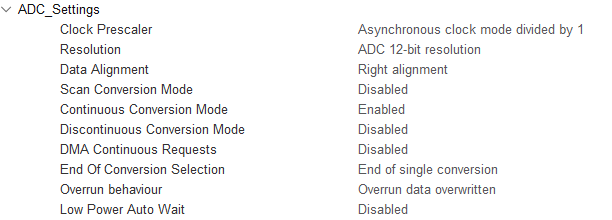

hi @Eleon BORLINI​ I have tried that please let m eknow how shall I configure cube MX
- How to configure ADC in STEVAL - MKSBOX1v1 (With DMA or W/o DMA)

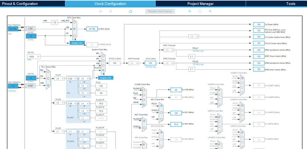

- How are the setting to be used for this board. (Clock dividing by ?) - For Audio it will be single channel continuous scan
The default configuration of ADC1 is without DMA. This ADC is dedicated to the analog microphone acquisition.
You can find the default clock tree configuration in the proper tab. The master clock is 120MHz. I would use this configuration.

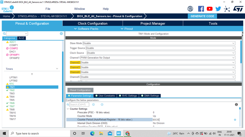

‎2021-11-17 6:48 AM
@Eleon BORLINI​ If I need to use 8Khz ,i.e High Quality Audio sampling how shall we do it , the clock freq for bus and main is 64 Mhz. If 1/8 KHz then it is 0.125msec
- What is the formulae for that to be loaded in the MX Cube.
- I need to capture the voice and transmit in the UART.
- Whatever we are speaking. for a minute
- What should be the buffer size to be configured.
- I have gone thro the Sensortile.box_audio but unfortunately it doesn't guide how to configure MX settings
‎2021-11-26 7:14 AM
Hi @Snara.2​ ,
PCM data is defined by sample speed (8kHz in your case) and bit depth, for example 16 bits (or 12 bits for the ADC resolution). This means that, for a N.1 minute acquisition, you need 8kHz * 12bit * 60 sec = 5760 kbit = 720kByte.
The STM32L4R9 on the Sensortile.box has:
- 2-Mbyte Flash, 2 banks read-while-write, proprietary code readout protection
- 640 Kbytes of SRAM including 64 Kbytes with hardware parity check
You might use the internal flash, but there is the concrete risk you'll saturate it.
So it's better you process your audio stream second by second, not minute by minute, at least if you want to do it in real-time. Otherwise you should find a memory for storage, such as a flash or the onboard SD card, but the processing will be no more in real-time.
