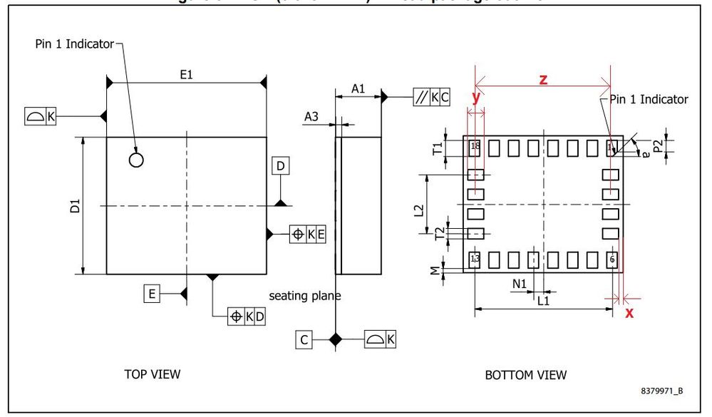

I am not able to get exact information for footprint creation of LSM9DS1, can anyone help pls
Chithambara Ganesh
Posted on January 25, 2017 at 05:13
x = ?
y= ?
z = ?

All the pads are the same.
x = M = typ. 0.1 mm
y = T1 = typ. 0.35mm
z = E1 - T1 - 2xM = typ. 2.95mm

Thanks Miroslav for your reply,
from your reply i am understanding in following way, Please correct me if i am wrong,
1) x = distance between component right edge and right edge of pin5
it is same as 'distance between component bottom edge &  bottom edge of pin 13' which is M=0.1mm
2) y = Pad width of pin 17
All pads from 1-18 are of same size
So y=T1=0.35mm
3) z= distance between center of Pins  2 and 17
z=E1-T1(pad width of pin 17)-2xM
so Z=2.95mm
Please conform ASAP.
Posted on January 25, 2017 at 12:08
Yes, your understanding is correct.
