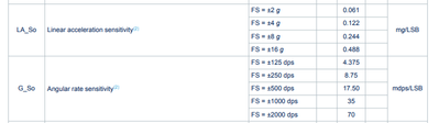

I'm working with LSM6DSOX and I managed to get the accelerometer and gyroscope data from the output registers, but the numbers don't seem to be meaningful, how do I convert the raw data to g?

Data from the output registers are in LSB, if you want to convert them to g you need to multiply the LSB values by the sensitivity corresponding to your FS:
