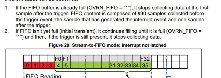

Posted on April 03, 2018 at 12:18
I saw this description in the manual of AN3308:
What I need now is the triaxial acceleration sample data when the interrupt is triggered. I configured the lis3dh chip into Stream-to-FIFO mode. After the interrupt was generated, 32 acceleration samples were read continuously. Although the data was different, the acceleration of that axis was not higher than the threshold I set. . It is unclear where the problem has arisen, and I hope to get your advice. Here is my configuration:
