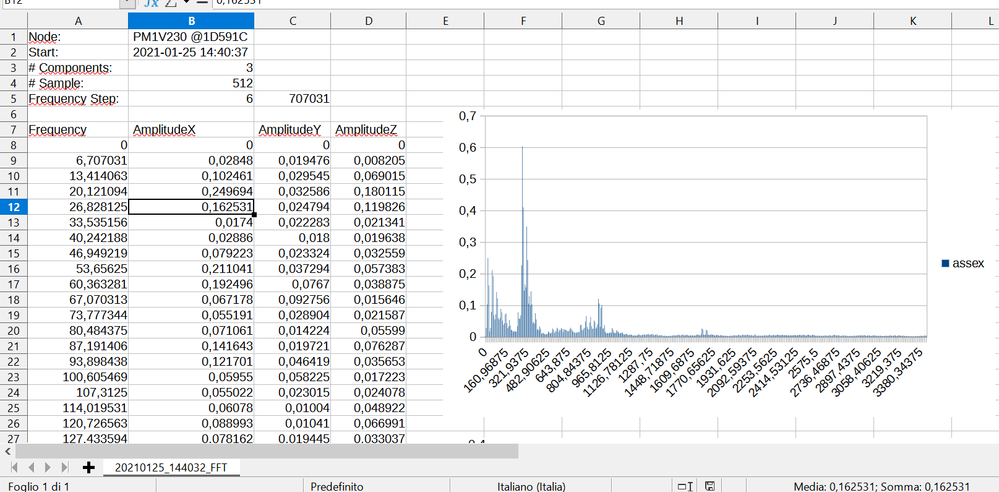

I would like to know how is the amplitude of the FFT calculated by the FP-IND-PREDMNT1 firmware related to the acceleration measured by the accelerometer found on the STEVAL-STWINKT1 board.
It is expressed in an absolute value but I need to know the relation to the intensity of the vibration/acceleration.

‎2021-02-23 3:40 AM
Hi @Eleon BORLINI​
thanks for the answer but it doesn't explain what I was asking, I'll show you what value of the FFT I need to evaluate so you can help me further.
The image attached is the representation of the FFT points acquired by the log of the PREDMNT firmware. I would ask you how are the amplitude values that you can seein the image related to the acceleration sampled by the accelerometer.
Thanks for your time and patience.
Andrea
‎2021-02-23 6:58 AM
Hi Andrea @ABent.1​ ,
Thanks for sharing the data for better comprehension.
As written before, the value in AmplitudeX, AmplitudeY and AmplitudeZ columns are expressed in m/s^2, meter on second square, the standard unit for the acceleration. They refer to the FFT values for each of the frequency points (in Hz). To convert these into "g", you have to divide them by 9.81m/s^2, and to get back the LSB you have to multiply them for 1/1000 * 1/sensitivity in mg/LSB.
Is it clearer now?
-Eleon
‎2021-02-23 7:08 AM
Hi @Eleon BORLINI​ ,
thanks for the fast and kind reply, now it is clear and you have solved all of my doubts!
