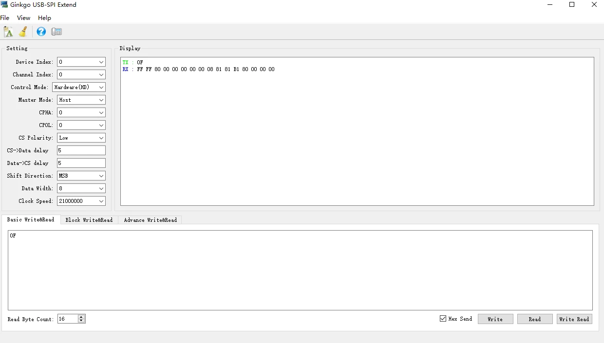

    LUKE1
    LUKE1Author
    April 15, 2023
    _legacyfs_online_stmicro_images_0693W00000bi96xQAA.png the ID is not OK

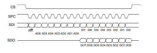

    Ciao @LUKE​ ,
    How are you implementing the read protocol of SPI?
    In order to read a register in SPI mode you need to follow this sequence:
    _legacyfs_online_stmicro_images_0693W00000biJbqQAE.pngIf my reply answered your question, please click on Select as Best at the bottom of this post. This will help other users with the same issue to find the answer faster!
    LUKE1
    LUKE1Author
    April 19, 2023
    when I use I2C interface , send :address0x19,subaddr,0x0f ,get the read value: 0x44, it is ok for the result. but use the SPI, I send ,read the value:FF FF 80 00 00 00 00 00 81 B1 80 00 00
