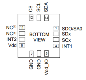

Does LSM6DSV32X and LSM6DSO32X are Same package? i Couldn't find Ordering information. Can anyone help on this. Thanks..!

Hi @MY V.1​ ,
LSM6DSV32X should not be available online, isn't it? Do you mean LSM6DSV16X?
In any case, both products have the same characteristics of the LSM6DSO32X: LGA-14L
(2.5 x 3.0 x 0.83 mm), with the pinout below:
0693W00000JOMaFQAX.pngThe NC pins can be auxiliary interfaces.

MY V.1
Hi Eleon,
Yes LSM6DSV32X this datasheet not available on line, meanwhile Does
Part# LSM6DSV32X/LSM6DSV16X are Same package?
Thanks..!
HI @MY V.1​ ,
Yes, I confirm LSM6DSV16X and LSM6DSO32X have the same package (LGA-14L
(2.5 x 3.0 x 0.83 mm))
-Eleon
