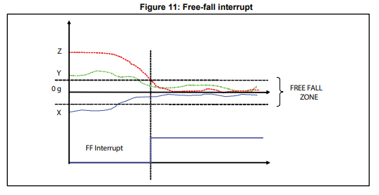

Hi Swati Upendra, @SUpen.1​ ,
you can also detect the free fall (strictly speaking), i.e. the event during which the device is falling (the 3 axis acceleration approximates to 0). See app note, p.26.0693W00000QNt1TQAT.png-Eleon
