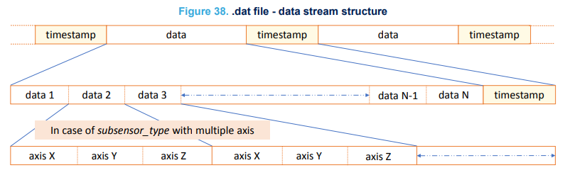

can FP-SNS-DATALOG1 output real-time data by usb?
YTan.5
i would like to output my sensor data by USB, it seems that is it places into a .dat file but how is it encoded ? or it is possible to get the value directly?

Hi @YTan.5​ ,
If I well understand, the question is about how data are saved in the .dat file, right?
If so, you can refer to the paragraph 2.6.5. of the User Manual UM2688.
Here in synthesis:
-Eleon
