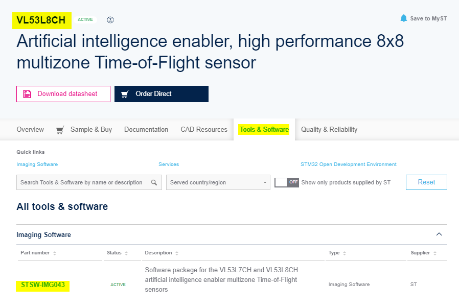

To view your histogram data, use the STSW-IMG043 GUI Package provided on the VL53L8CH product page.
This package is supported on the Windows operating system.
Note: You must have a myST account to download the software. If you are a registered community user, you already have a myST account. If you do not have an account, visit this page to create one.

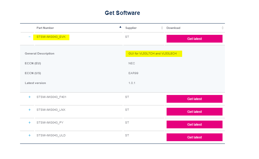

On this page visualized on the image below, you can find a link to the STSW-IMG043 package under the "Imaging Software" section. This package provides you with a GUI that can view histogram data. To view other features of the package, read the user manual inside the package or check the end of this article.
After clicking on the STSW-IMG043 package, you are redirected to the specific STSW-IMG043_EVK package that you can download.
Navigate to the bottom of the webpage, the package is available under the "Get Software" section.
The image below highlights the package you need:
