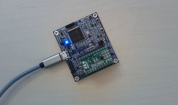

To get started, connect the STEVAL-MKI109V3 board to the PC via USB and open MEMS-Studio.
Figure 4: ProfiMEMS STEVAL-MKI109V3 board connected to the PC via USBFigure 4: ProfiMEMS STEVAL-MKI109V3 board connected to the PC via USB

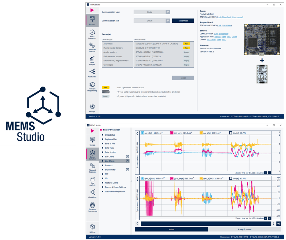

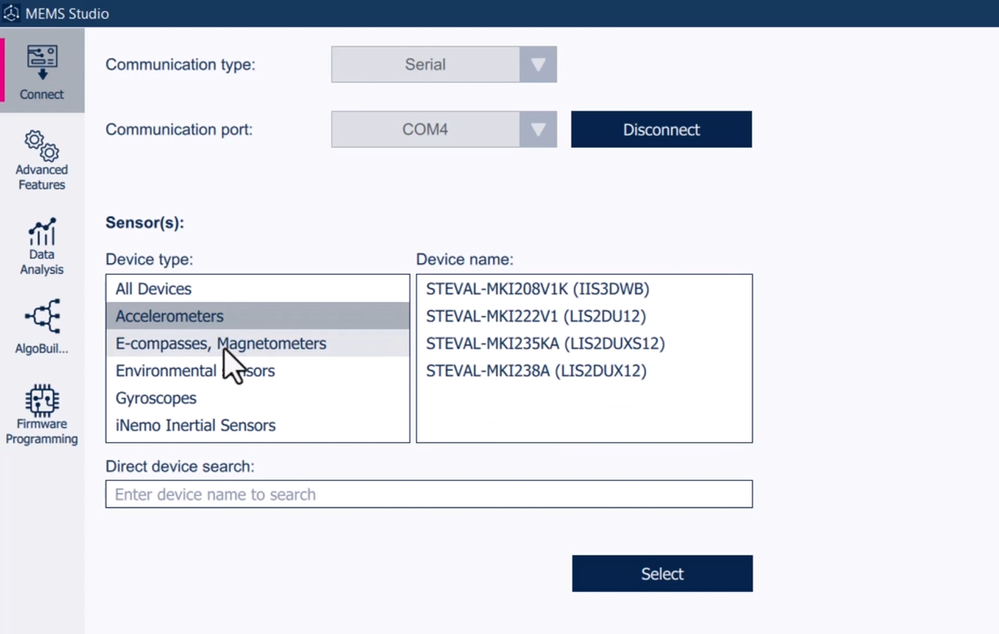

Inside the tab [Connect] choose [Serial] as the communication type, select the correct communication port to which the device is connected and click on [Connect].
When the connection is completed, MEMS-Studio recognizes which board is connected and present a list of possible devices, which you can connect to the ProfiMEMS board. To find a device, you can either scroll through the device names or search by device types (such as accelerometer, e-compass, magnetometers, environmental sensors, gyroscopes, iNEMO inertial sensors). Alternatively, type the device name inside the [Direct device search] bar.
Figure 5: MEMS-Studio - Connect sectionFigure 5: MEMS-Studio - Connect section

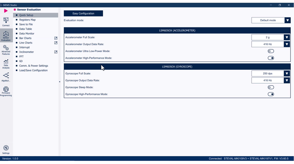

In this case, select STEVAL-MKI197V1 (LSM6DSOX). After selecting the correct device, you are automatically switched to the [Sensor Evaluation] tab: from here, you can configure your sensor, such as selecting the scale and ODR. In this hands-on, click on the [Easy configuration] button for quick evaluation. Now, you are able to stream data from the sensor and visualize the output in real-time. You can press the [Play] button in the top-left corner and select which method to evaluate the sensors such as bar charts, line charts and fast Fourier transform (FFT).
Figure 6: MEMS-Studio - Sensor Evaluation sectionFigure 6: MEMS-Studio - Sensor Evaluation section

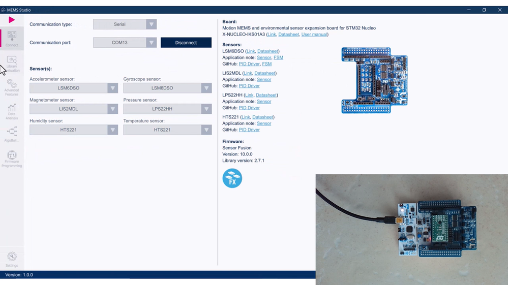

MEMS-Studio can also be used to evaluate custom libraries through devices. As an example: Using the MEMS sensor expansion board X-NUCLEO-IKS01A3 with a STM32 Nucleo board using the datalogger firmware available from X-CUBE-MEMS1.
Figure 7: MEMS expansion board for STM32 NucleoFigure 7: MEMS expansion board for STM32 Nucleo

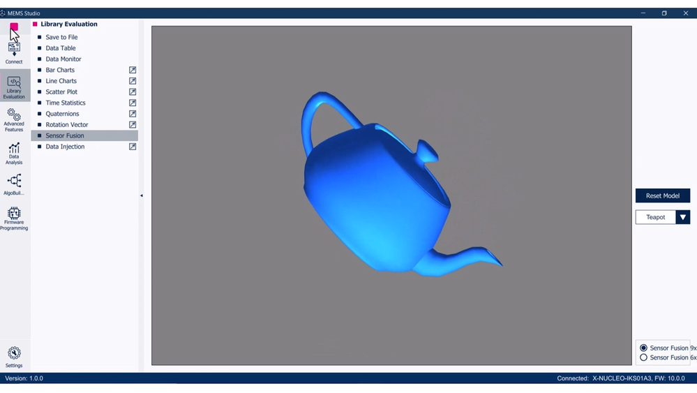

Moreover, you can visualize the orientation of MEMS sensor in real time inside the [Sensor fusion] tab.
Figure 8: MEMS-Studio - Sensor Fusion tabFigure 8: MEMS-Studio - Sensor Fusion tab

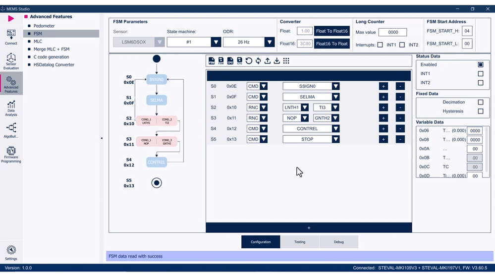

Under the FSM section, you can create or load a configuration inside the [Configuration] tab.
Figure 9: MEMS-Studio - FSM Configuration sectionFigure 9: MEMS-Studio - FSM Configuration section

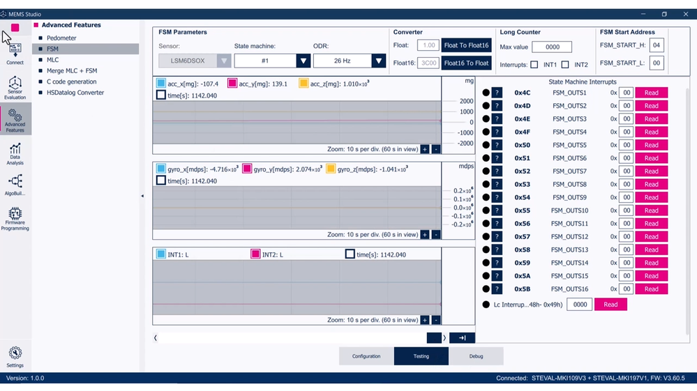

Under the FSM section, you can evaluate the sensor in real time inside the [Testing] tab.
Figure 10: MEMS-Studio - FSM Testing sectionFigure 10: MEMS-Studio - FSM Testing section

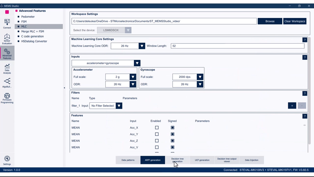

The MLC section is available with all the same features already present in Unico-GUI: you can load data logs, generate ARFF files, train and deploy decision trees, visualize the output of your decision tree, debugging by injecting previously recorded data logs.

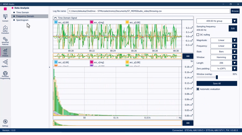

Under the [Data Analysis] section, you can load and visualize all data logs in the same place.
Figure 12: MEMS-Studio - Data Analysis sectionFigure 12: MEMS-Studio - Data Analysis section

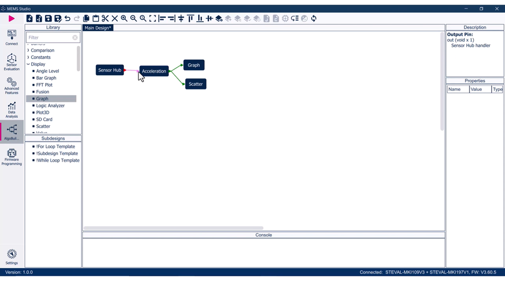

AlgoBuilder is incorporated in MEMS-Studio, which allows you to build and to flash custom algorithms using graphical design. For example, consider a simple algorithm that graphs acceleration onto a scatter plot: Here is its graphical design.
Figure 13: MEMS-Studio - AlgoBuilder sectionFigure 13: MEMS-Studio - AlgoBuilder section

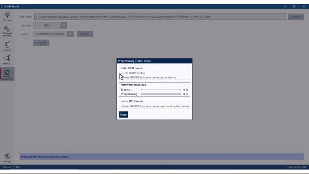

Finally, inside the [Firmware Programming] section we can flash any device. The image below demonstrates the flash of the ProfiMEMS using the evaluation software for MEMS-Studio.
Figure 14: MEMS-Studio - Firmware Programming sectionFigure 14: MEMS-Studio - Firmware Programming section
