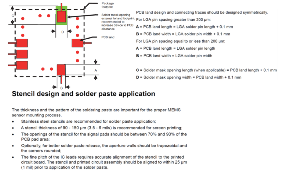

2.1. PCB design rules for the footprint
Footprint design rules are taken from technical note TN0018. Note that all lands have to be the same size, no need for large lands.
Figure 3. Footprint design rulesFigure 3. Footprint design rules

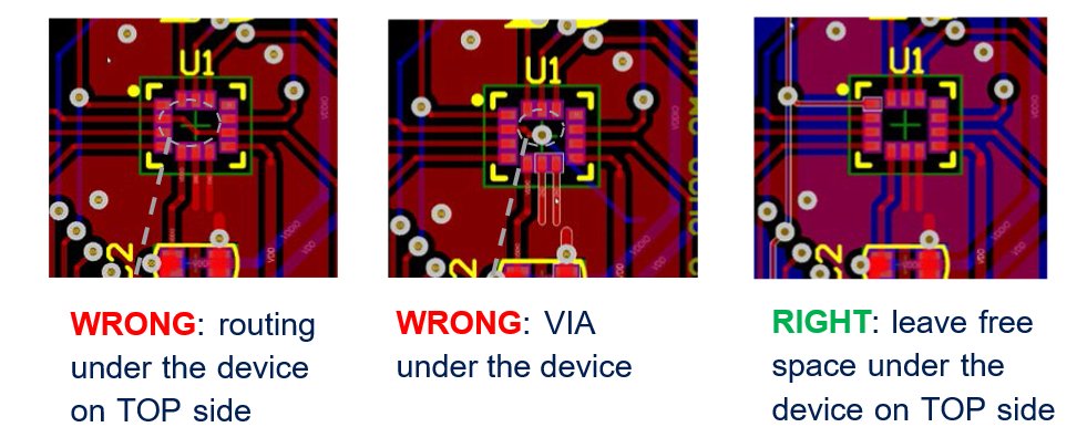

2.3. Placement rules for the top side
For all MEMS devices, the device is soldered on the top side.
Never place any routing or via on the top side under the device, refer to the following figure.
Figure 5. Examples of top side placementFigure 5. Examples of top side placement

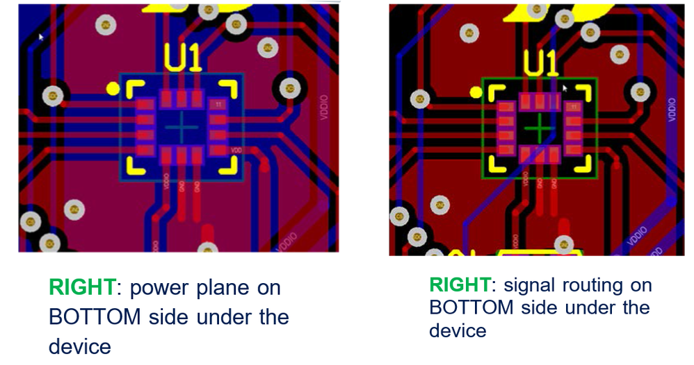

2.4. Placement rules for the bottom side
Placement rules for the bottom side apply only to MEMS accelerometer, gyroscope, and pressure sensors. It is possible to use the bottom side under the device for power plane or signal routing.
Figure 6. Examples of bottom side placementFigure 6. Examples of bottom side placement

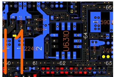

2.5. LGA package layout hints - extra tips
The following figure shows an actual case from the field.
The customer was facing a little offset shift on the zero-g and zero-rate level. The following points were identified as incorrect practices:
  • Pins 6 and 7 are not soldered: this can cause mechanical stress on the inner sensors.
  • Vias below pads: it is better to move these outside the component.
  • Copper traces below the component have to be avoided (trace of pin 8 should flow directly outside the component).
Figure 7. Example of incorrect layout from real caseFigure 7. Example of incorrect layout from real case

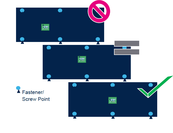

3.2. Fasteners on the PCB
PCB boards are generally housed and fixed in an enclosure. Inertial MEMS sensors should be located between fasteners so as to minimize and distribute homogenously the stress on the MEMS sensor. This is illustrated in the following figure. When this is not possible, the location, which best meets this criteria is to be selected.
Figure 8. Placement of sensor between fastenersFigure 8. Placement of sensor between fasteners

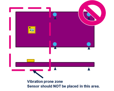

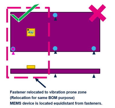

3.3. Areas of stress on the PCB
The PCB board illustrated in the previous figure is a symmetric rectangular board. In real life applications, the probability of having a symmetric board is unlikely. In most cases, PCBs have protruding sections and without fasteners. These locations are prone to vibrations, which can provide false readouts and thus it is highly advisable that the MEMS sensor be located away from such areas.
Figure 9. Placement of sensor in area without vibrationsFigure 9. Placement of sensor in area without vibrations

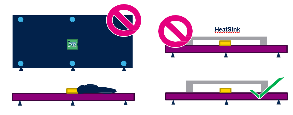

Sources of stress can be the use of epoxy resin materials to cover the CPU. It can also be usage of heat sinks or other foreign structures, which are in contact with the MEMS sensors. These conditions are sources of high stress and need to be removed from the design.
Figure 10. Examples of sources of stress to the sensorFigure 10. Examples of sources of stress to the sensor

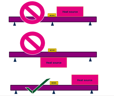

3.4. Recommended placement of a heat source with respect to the MEMS sensor
The presence of a heat source in the surrounding area of the MEMS sensor causes undesired internal movement.
To reduce the probability of mechanical stress, locating the heat source away from the MEMS sensor is recommended.

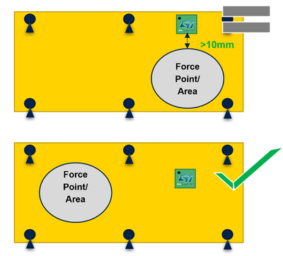

3.5. External loads/forces
Certain applications allow the possibility for external loads/forces to be exerted on the board. One example might be a series of pushbuttons or connection points, which are used during normal operation.
These forces are transferred to the board and hence to the MEMS sensor. Placing the MEMS sensor away from these sources and keeping it at least 10 mm away from the source of the external force reduces the effect on the MEMS sensor.
Figure 12. Placement of sensor far from external point of forceFigure 12. Placement of sensor far from external point of force
