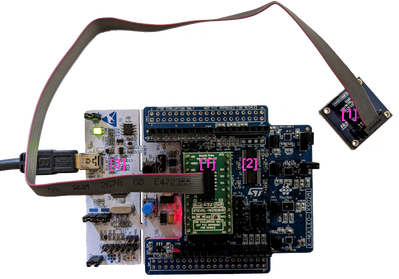

Hardware
The following hardware components are used:
[1] STEVAL-MKI230KA, which is the DIL24 adapter board for ISM330IS, the industrial IMU MEMS sensor with ISPU;
[2] The industrial motion MEMS sensor expansion board X-NUCLEO-IKS02A1;
[3] NUCLEO-F401RE, STM32 Nucleo development board.

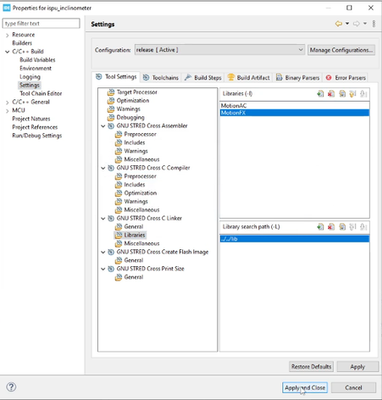

If you go back to STM32CubeIDE, right-click on the name of the ispu_inclinometer project inside the project explorer window: click on properties. Then click on settings inside the section C/C++ build and finally on libraries under the section GNU STRED Cross C Linker in settings inside the section C/C++ build. Now, click on the add button in the libraries section on the right-hand side of the properties window and call it MotionFX. To finalize this step, click on apply and close.

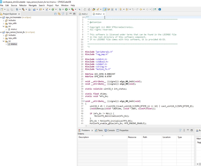

You can now modify the code. First of all, open the main.c file inside STM32CubeIDE. Then import the sensor fusion example (sensor_fusion_6x) in the project by selecting its Eclipse folder inside the x-cube-ispu folder. Open its main.c file.
Open the two main.c file (the one of ispu_inclinometer project and the one of ispu_sensor_fusion_6x project inside the project explorer section), side by side.
Start integrating by copying from the ispu_sensor_fusion_6x project to the ispu_inclinometer project the following lines of code:

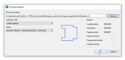

 After saving the updated ispu.json file, open AlgoBuilder tool: click on file, then new design. The firmware settings pop-up window appears:
  • Browse to choose the location where the firmware project is generated by AlgoBuilder: for example, in a new folder called workspace_algobuilder/inclinometer_fw.
  • Choose NUCLEO-F401RE + X-NUCLEO-IKS02A1 + ISM330IS as the target.
Save this design file for AlgoBuilder by naming it inclinometer.xml in the folder called workspace_algobuilder.

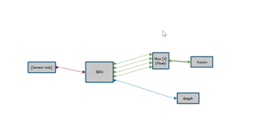

Then add the ISPU block by looking for ISPU inside the filter bar (in the left hand corner of AlgoBuilder). Connect it to the sensor hub inside the main design section of AlgoBuilder. In the properties window, click on Load ISPU UCF file and open the ispu.ucf file of our inclinometer project.
To visualize the fusion block, look for Fusion inside the filter bar. The fusion block takes in input four float values. So, look for mux block inside the filter bar and add it between ISPU and fusion block. The mux block can be configured for four values, by setting: Number of inputs = 4 inside the properties section. Its inputs are the four quaternion values coming from the ISPU block. If you want to visualize the status of the calibration, look for graph inside the filter bar, add the block in the graphical view and configure it with
  • Number of Curves = 1
  • Graph Name = Acc cal
  • Waveform 1 Name = Status
  • Auto-scale ON
inside the properties section. Then connect this block to receive the input from the ISPU block.
Then you can build the project by clicking the dedicated button in the top bar: this automatically generates a firmware based on the created flow, shown by the graphical view in the main design window (see the picture below), and is built using the STM32CubeIDE.

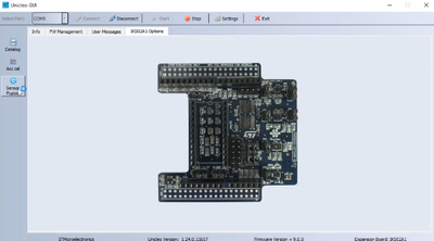

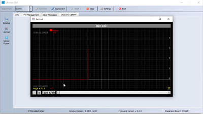

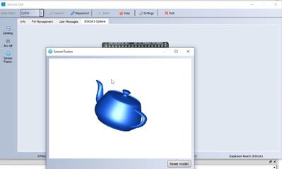

When Unicleo-GUI opens, on the left you can see both the Acc cal and sensor fusion tabs.

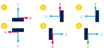

Click on start. If you click on the Acc cal tab, the value now is zero because it is not calibrated. Move the device for a few seconds along all the six faces as described in the picture below to connect all the point needed to complete the accelerometer calibration:
After this calibration, the accuracy of Acc cal is higher.
Click on the sensor fusion tab: if you put the device flat on the table, the model (represented here by a teapot) is flat. If the device is tilted along the axes, the teapot is moving accordingly, and everything is extracted with accuracy.
