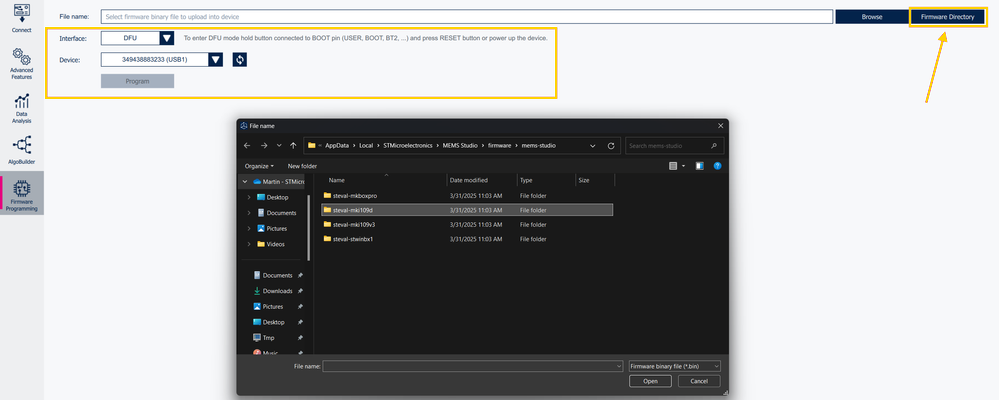

Flash the latest firmware, located within the MEMS Studio installation folder at: <mems-studio_folder>/firmware/mems-studio/steval-mki109d/, to enable communication between MEMS Studio and the sensor. Navigate to the "Firmware Programming" page. Connect the device (select the DFU interface and switch the device into DFU mode to establish a connection). Click the [Firmware Directory] button (this action will locate the firmware folder) and then select the "steval-mki109d" binary. Click the [Program] button. The programming action should execute and display the result (status).
Figure 5: MEMS Studio - Firmware ProgrammingFigure 5: MEMS Studio - Firmware Programming
NOTE: This can be also achieved through STM32CubeProgrammer.

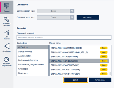

In MEMS Studio, go to the "Connect" page, select "Serial" as the communication type and the serial port the board is connected to as the "communication port", then press [Connect]. Search and [Select] the "STEVAL-MKI246KA (IIS2DULPX)."6.png

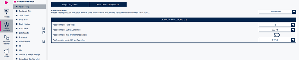

Navigate to the "Sensor Evaluation" page and select the "Quick Setup" tab to configure the sensor according to your preferences (or select easy configuration). Press the ▶ button in the top-left corner to begin streaming data from the sensor.
Figure 7: MEMS Studio - Quick setupFigure 7: MEMS Studio - Quick setup

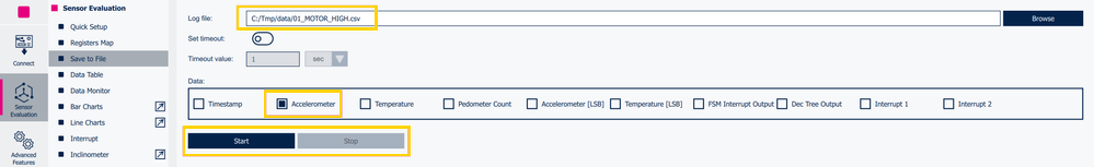

Navigate to the "Save to File" tab. Select a save path for the CSV log within the data/<id>_<activity> folder (where <activity> corresponds to the desired activity name and <id> corresponds to the numeric identifier used for its classification). Select [Accelerometer] in the "Data" section.
Figure 8: MEMS Studio - Save to FileFigure 8: MEMS Studio - Save to File
Use the [Start] and [Stop] buttons to initiate and terminate data collection. Ensure that data is acquired in the most realistic setting, with only one activity type per log.
Example use case: We want to acquire data to create an MLC class for an air blower running at high speed. In this case, the sensor would be attached to the air blower.
Start the air blower at high speed. Start data collection using the [Start] button. The timeout feature (set, for example, at 30 seconds) can be used for this purpose. After the specified period (which depends on data complexity), use the [Stop] button to stop data collection manually. Alternatively, use the timeout feature. Data is automatically saved in the specified file.
Now, stop the air blower. We now collected data that is used later to create an MLC class. Repeat this process for each activity the MLC should classify. Use activities specific to your use case.

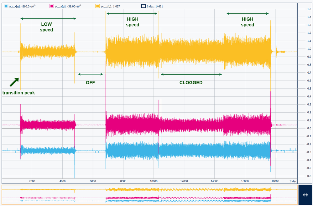

The graph below visualizes the data for each activity of the air blower and transitions between these activities (transition peaks). The difference between each activity is most visible on the Z-axis line, so it is used to highlight individual data patterns. Each activity possesses unique characteristics that serve to differentiate it when configuring the machine learning core (MLC.)
Figure 9: Data Analysis - exampleFigure 9: Data Analysis - example

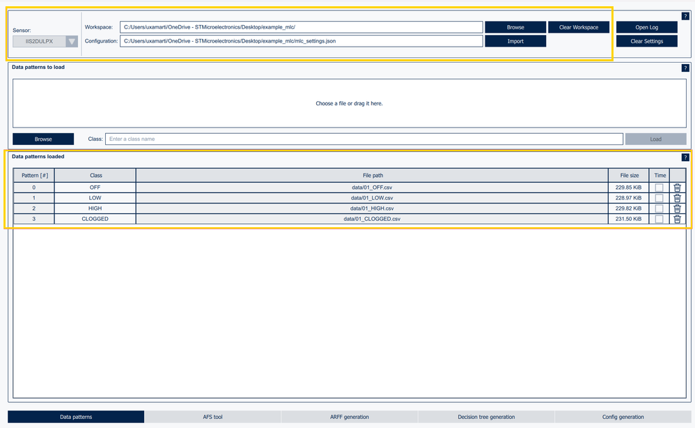

6. Data patterns
This step loads individual data patterns from the dataset and assigns a *class name* to each group of these patterns. Multiple data patterns can be loaded to describe a single activity (class.) For simplicity, this example utilizes only one data pattern per class.
Open MEMS Studio, go to "Advanced Features" → "MLC" and select data patterns tab. In the "Workspace" option, specify a path to the desired output folder for the configuration. In the "Sensor" option, select [IIS2DULPX]. This action initializes the workspace and creates the workspace settings JSON file within the specified folder. Use the "drag and drop" feature, or the [Browse] button in the "Data patterns to load window" to load the individual data patterns. For each loaded data pattern, specify a class name and then click the [Load] button.
The result of the previous steps should look similar to this (including the workspace settings above):

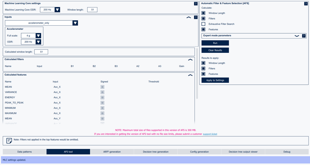

7. AFS tool
The AFS tool processes the specified data patterns and user-defined settings and recommends window length, filters, and features that can be used for decision tree generation. Such features and filters can then be reviewed and applied to the configuration, primarily influencing ARFF file generation.
Open the "AFS tool" tab. Specify the "Inputs" window selection (in accordance with the values used during data acquisition): accelerometer_only, FS: 4 G, ODR: 200 Hz. Specify the "machine learning core ODR"(which must be less than or equal to the sensor ODR), in this case it is 200 Hz. Click the [run] button to start the calculation. Once the calculation is complete, the features and filters can be applied to the settings using the Apply to Setting button.
This configuration should result in the message "MLC settings updated".  See the screenshot below of the tab after completion for orientation:
Figure 11: MEMS Studio - AFS toolFigure 11: MEMS Studio - AFS tool

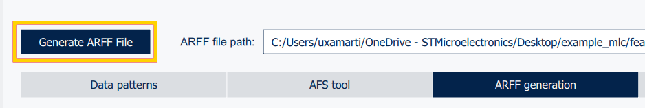

8. ARFF generation
This tab displays the features and filters previously recommended by the AFS tool; each can be individually modified, deleted, or new ones can be added. The sole step on this tab is to click the [Generate ARFF File] button (there is no need to specify a path). The ARFF file will then be created and stored in the workspace.

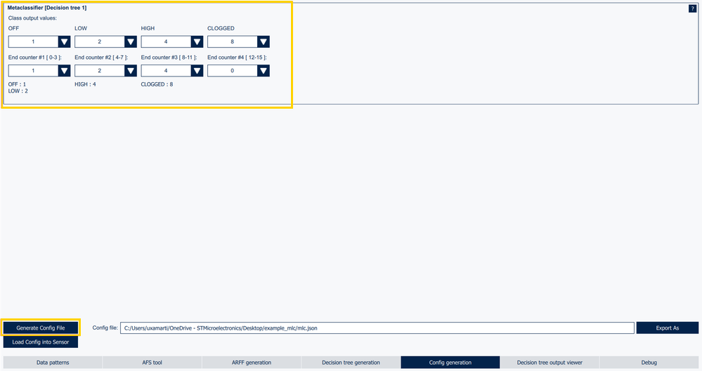

10.  MLC configuration generation
This tab enables the setting of output values for each class, the specification of end counters, and the generation of the final MLC configuration file. If your dataset differs from this example, adjust the values according to your preferences. If you are using the dataset from the data folder, select values as shown in the screenshot below:
Figure 13: MEMS Studio - MLC configuration generationFigure 13: MEMS Studio - MLC configuration generation
Note: The configuration file can be exported to a C header file using the [Export As] button. This file can then be included in a C project for straightforward MLC configuration.

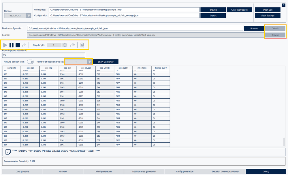

11.2 Debug tab
The debug tab option also operates with a connected device but does not utilize live data from the sensor. Instead, it processes a datalog, extracting data (for example, acceleration) and submits it to the MLC. The output of this process is another datalog. It contains the original sensor data along with the MLC's "result" or "reaction" to that data in the form of MLC output.
This functionality enables the capture of data (for example, acceleration), saving into a log file, and subsequent utilization of this log file to evaluate an MLC configuration. This feature is demonstrated in the following steps. Each individual datalog in the dataset located in the "data" folder was created during an air blower demonstration. It is not possible to access the demo to evaluate the configuration "live". However, the data_validate folder contains a log named Test_data.csv. This log contains measured data (accelerometer only) from a brief demonstration of the demo's capabilities, making it suitable for evaluating the MLC configuration.
Navigate to the "Debug" page under "Advanced Feature" → "MLC".
In the "Device configuration" path, you can select [Default] (which loads the configuration from the current workspace) or [Browse] for a specific configuration to evaluate. Select the path to the file data_validate/Test_data.csv as your log file. Set the "Number of decision tree set" option to [1] (in accordance with the decision trees in your configuration). Click [Run].
A progress bar is displayed. Processing this data might take some time. The process should look similar to the screenshot below:
Figure 14: MEMS Studio - MLC DebugFigure 14: MEMS Studio - MLC Debug
Once the process is complete, select the [LOG] option from the menu to save the data. Reference process result can be found at data_validate/Test_data_result.csv.
Note: If you exit the tab, the process stops and the table with result data is discarded. Remember to save using the LOG option.

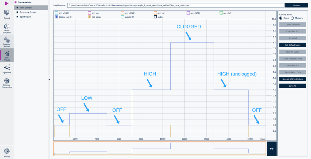

You should now have a datalog containing the results from the MLC. The "Data Analysis" page can be utilized to visualize the data. While this page offers numerous options for data visualization, the "Time Domain" option is the most straightforward option. In this tab, you can specify the result log file path in the "Log file name" option and visualize only the MLC data (or any desired data) by disabling all values except dectree and mlc_status.
An example of "Data Analysis" with each activity described is described below. If you used the same dataset and submitted the same testing datalog, you should have the same result as in the picture.
Figure 15: Data analysis - resultFigure 15: Data analysis - result
