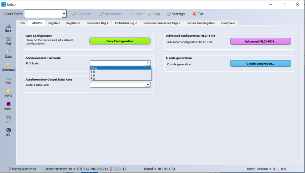

Using Unico GUI, the accelerometer is configured with ±0.5 g full scale and 26 Hz output data rate. The reference position, when both detected tilt angles are 0 degrees, is when the x-y plane of the sensor is orthogonal to the gravity vector.

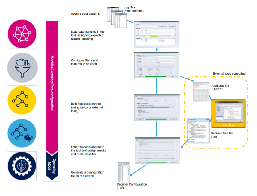

Referring to the AN5536 application note:
Algorithm configuration
A 2nd order low-pass IIR filter with cutoff frequency of 5 Hz and gain = 1 (for ODR = 26 Hz) is configured to filter the accelerometer data. Two features have been used for building the decision tree: the mean of the x-axis and the mean of the y-axis of the filtered accelerometer data. The MLC runs at 26 Hz, computing features on windows of 1 sample (corresponding to 38.5 milliseconds), in order to ensure maximum responsiveness. As anticipated before, two decision trees with 255 nodes were configured to detect different classes. Each class represents a tilt angle in the given range. Meta-classifiers are not used. In order to build the decision trees, Weka tool can be used (LINK), or with a dedicated built-in program (LINK).

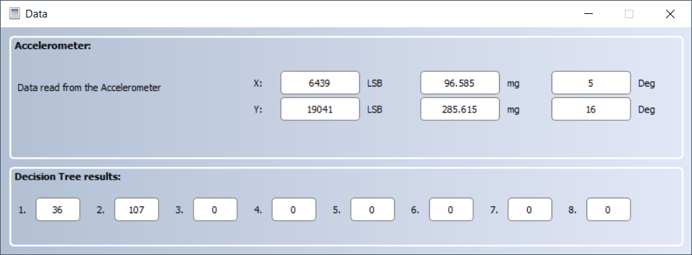

The easiest way to evaluate the results is using the ProfiMEMSTool with the STEVAL-MKI209V1K and Unico GUI. Run Unico GUI and connect the ProfiMEMSTool with inserted STEVAL-MKI209V1K board to the PC by using a micro USB cable. Select IIS2ICLX from the list of Device Names, keep the "Communication with the motherboard [Enabled]" option box checked and click the Select Device button. Go to the Load/Save tab, click the Load button, browse for the generated UCF file and then click the Open button. Wait until the file is Loaded, click the Start button and open the Data window by clicking the Data button from the option panel on the left side.
The MLC output value is expressed as an 8-bit value in two’s complement and must be multiplied by the angular sensitivity mentioned in the output of the iis2iclx_tilt_angle_DT_generator.exe program (default is 0.15748 deg/LSB).
For example, in the figure above, text box 1 shows a value of 36 and text box 2 shows a value of 107. These values correspond to an inclination in the x and y axes. The values are represented as a two’s complement number, from which it can be determined that both are positive numbers. Therefore, they can be directly converted to the inclination angle value in degrees by multiplying them by the angular sensitivity:
36 * 0.15748 = 5.67 degrees
107 * 0.15748 = 16.85 degrees
