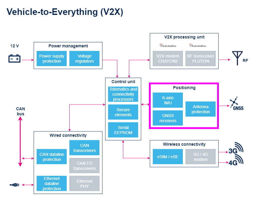

The IMU ASM330LHB is an automotive-qualified MEMS inertial-sensing module which addresses functional-safety applications up to ASIL B if it is used in redundancy with the software library ASILB-LIBRARY.
This solution is used to target ASIL B applications that need information about the linear accelerations and angular rates of the vehicle. Use cases can range from in-dash car navigation, precise positioning, V2X (vehicle-to-everything), radar, lidar, and camera stabilization systems or others.
An application example is shown in the picture below, which describes a precise positioning module where IMU sensors are used together with GNSS receiver and antenna protection.
Figure 1: Application example where a precise positioning module based on ASM330LHB is used.Figure 1: Application example where a precise positioning module based on ASM330LHB is used.
In this scenario, ASM330LHB is the candidate as a 6-axis IMU because of its high-accuracy inertial measurements. In fact, it can improve the precise positioning of the car in context if it is used in redundancy with the software library ASILB-LIBRARY.

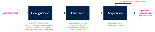

Interfacing the sensing module composed of two ASM330LHB IMUs involves the following phases:
  • Configure the sensing module
  • Check that the sensing module before starting the data acquisition
  • Acquire and runtime check the data coming from the sensing module
Each library API returns an error code.
  • An error is uniquely represented by a bit flag
  • The error code is an unsigned integer number containing the OR-ed bit flags
Figure 3: Design concept of ASM330LHBxx_ASILB_library.Figure 3: Design concept of ASM330LHBxx_ASILB_library.

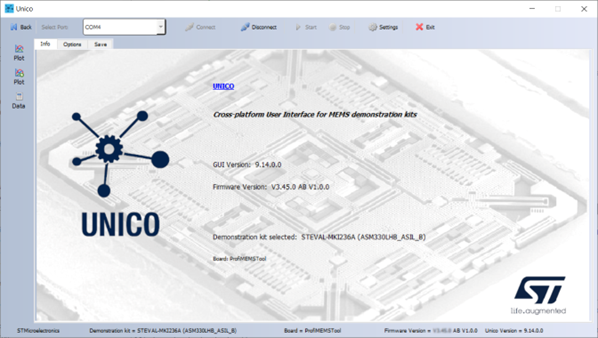

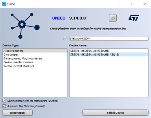

Here is a demo based on ASM330LHBxx_ASILB_library in the Unico-GUI for the ASM330LHB, using DIL24 STEVAL-MKI236A connected to the STEVAL-MKI109V3 motherboard.
After launching the Unico-GUI software, choose the STEVAL-MKI236A board with ASM330LHBxx_ASIL_B support, and click on the [Select Device] button. Once the device is selected, the main window appears in a few seconds.  The current firmware implementation communicates with the sensor using the SPI communication protocol.
Figure 4: Unico launcher.Figure 4: Unico launcher.

The integration provided consists by the following tools:
  • Accelerometers plot
  • Gyroscopes plot
  • Data visualization

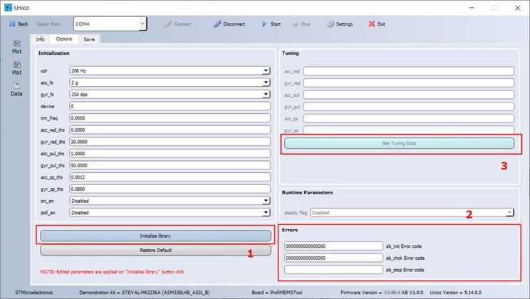

3.1 Library configuration
The main window exposes the following tabs:
  • Options
  • Save
The Options tab allows the user to initialize ab_struct and set selected parameters on the device once the [Initialize library] button is clicked. The mentioned button requests ab_init and ab_chck command execution. All parameters are set in the ab_struct including the read-only “device” parameter, which cannot be edited by the user since it is hardcoded according to the device selected.
Once the [Initialize library] button is clicked, if the ab_init error code is null, the [Start] button is enabled and the sensor data stream can be requested.
Error code box, box 2 in Figure 8, lists:
  • ab_init error code (Populated after ab_init execution is triggered by the [Initialize library] button)
  • ab_chck error code (Populated after ab_chck execution is triggered by the [Initialize library] button)
  • ab_stop error code (Populated after the [Get Tuning Data] button is clicked)
Figure 8: [Options] tab.Figure 8: [Options] tab.
Unico button command
[Start]
ab_start
[Stop]
ab_stop
ab_init + ab_chck
The tuning box exposes tuning parameters retrieved on stop requested by clicking the [Get Tuning Data] button (button 3 in Figure 8). This button cannot be clicked if the [Start] button was never clicked.
The runtime box in the options tab contains steady flag control to set a steady flag parameter on the device while sensors are streaming data. The steady flag should be enabled when the device is in a steady condition, and it enables dedicated checks during the ab_process instructions execution. When the control value is changed, the *ab_stdy command is sent to the library with a value to set.

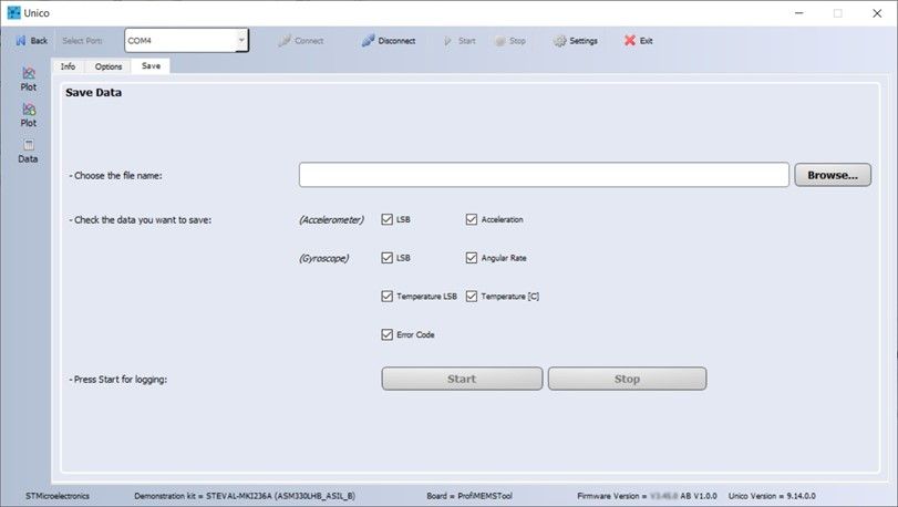

3.2 Data logging
The save tab allows the user to save a stream of sensor output data including error code on a dedicated log file selected by clicking the [Browse…] button, the user can select data to store. Once the destination file path is selected, the [Start] and [Stop] buttons define the acquisition period.
Figure 9: [Save] tab.Figure 9: [Save] tab.
More details are available in the user manual UM3134.
