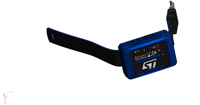

We are going to use a specific 3D-printed case for SensorTile.box PRO to be able to mount a board on our wrist like a smartwatch. To do this, we decided to use a dedicated case, whose 3D drawing Model can be found as STEVAL-MKBOXPRO 3D Drawing Model 1.0 in the CAD resources section.
Figure 1: 3D model of the SensorTile.box PRO case for wearable applications.Figure 1: 3D model of the SensorTile.box PRO case for wearable applications.

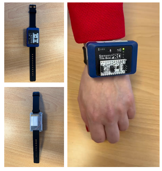

In general, a DIL24 adapter of an external MEMS sensor can be connected to the DIL24 socket of the SensorTile.box PRO. So, we have connected a DIL24 adapter of the LSMDSV32X sensor, STEVAL-MKI240KA, on the top of the SensorTile.box PRO to develop our wearable application, as shown in Figure 2.
Figure 2: Hardware setup for a wearable application: SensorTile.box PRO + LSM6DSV32X DIL24 adapterFigure 2: Hardware setup for a wearable application: SensorTile.box PRO + LSM6DSV32X DIL24 adapter

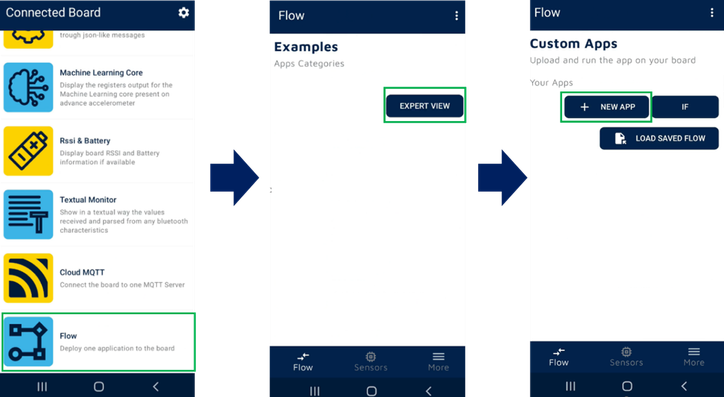

The SensorTile.box PRO can be easily connected via Bluetooth to your smartphone through an app called the STBLESensor app. From the STBLESensor app we can control the SensorTile.box PRO and develop our application. To start creating our application, we need to do the following in the STBLESensor app:
Go to [Flow] -> [Expert View] -> [New App] and then select IMU with the MLC in the Expansion DIL24 section.
Figure 3: Setting of the parameters inside STBLESensor app.Figure 3: Setting of the parameters inside STBLESensor app.

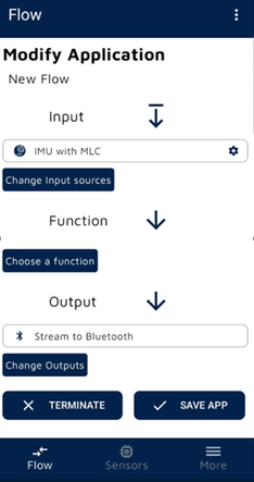

Now, we can load the LSMDSV32X configuration to our sensor through a configuration file (lsm6dsv32x_activity_recognition_for_wrist.ucf).
Then we can enable the data stream from the board to the phone through Bluetooth.
Finally, we can save the application created and download it to the SensorTile.box PRO. Figure 4 sums up all these steps.
Figure 4: The new flow created inside STBELSensor app.Figure 4: The new flow created inside STBELSensor app.

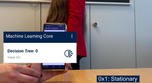

  • 0x1 when the user is steady
Figure 5: Stationary class is detected by the wearable application.Figure 5: Stationary class is detected by the wearable application.

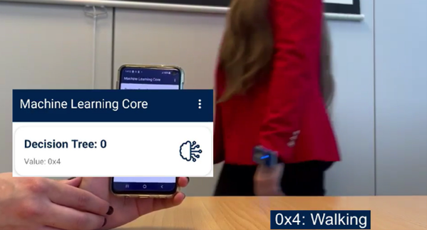

  • 0x4 when the user is walking
Figure 6: Walking class is detected by the wearable application.Figure 6: Walking class is detected by the wearable application.
