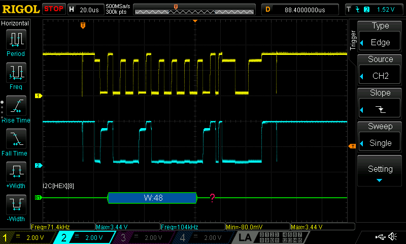

MKRZero (Master), STM32F4 (slave), 1kOhm pull-ups
CubeOrange(Master), STM32F4(Slave), 1k8 Ohm internal pull-ups, R1 = inf Ohm, Rn = 1k8 Ohm
CubeOrange(Master), STM32F4(Slave), R1 = 1k Ohm, Rn = 643 Ohm
CubeOrange(Master), STM32F4(Slave), R1 = 3k3 Ohm, Rn = 1k2 Ohm
Added ‎2025-03-05 12:38 AM
Posted in: STM32F4 as I2C Slave getting BERR on with specific Master device. - ( ‎2025-03-05 1:06 AM )
