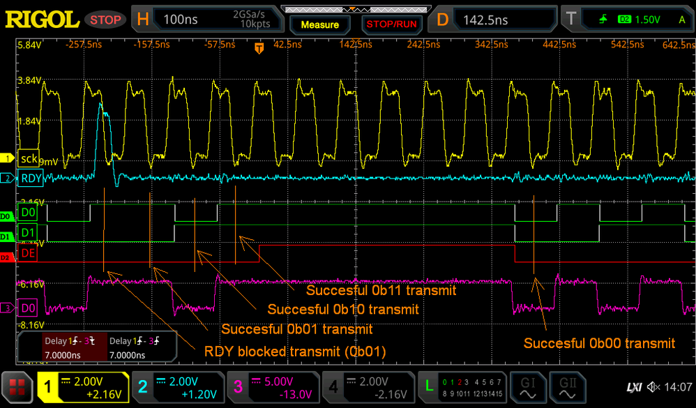

First transmittion after RDY assert
overall view
Lastr transmittion before RDY deassert
with delay, it is ok
Transmitting "correct" data (or two byte lost)
suspicious manipulating with data during DE deassert
Stop transmission due RDY and then DE deassert

Valid situation
Invalid behaviour
another invalid behaviour

Valid situation
Added ‎2025-01-28 4:19 AM
Valid situation
Posted in: STM32H7R3 PSSI RDY/DE bug - ( ‎2025-01-28 4:24 AM )
